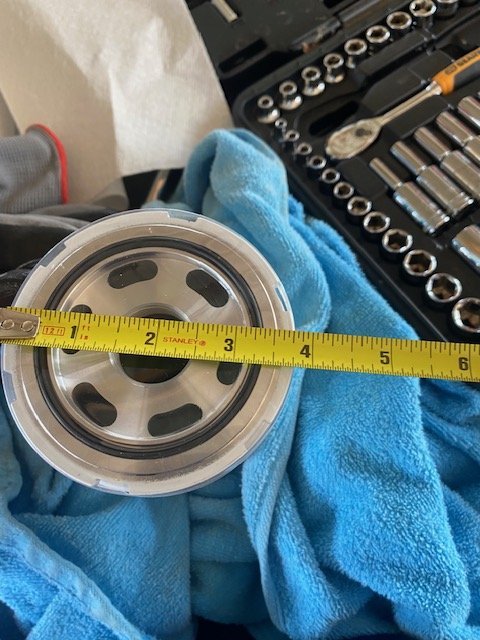

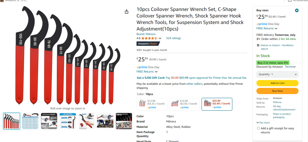

I used a C hook spanner and it seemed to grip the filter good and it didn't budge trying it. So I put a cheater on it and it stripped off the only tooth I can get the spanner onto so its dang tight.
I am going to order a new C hook adjustable style spanner that I hope to be able to get to another notch. Also, going to try either a chain wrench or strap wrench too to add more torque.
I have thought about wrapping the filter with friction tape then using a couple of hose clamps to tighten down to make a tooth for the new spanner wrench. OR use the hose clamps to be able to hit a drift to help loosen it while using strap wrenches. The notches in the filter don't leave much access for a helper to be able to hit them at at a good angle.

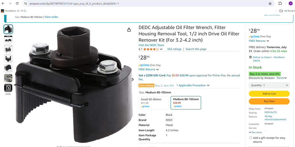

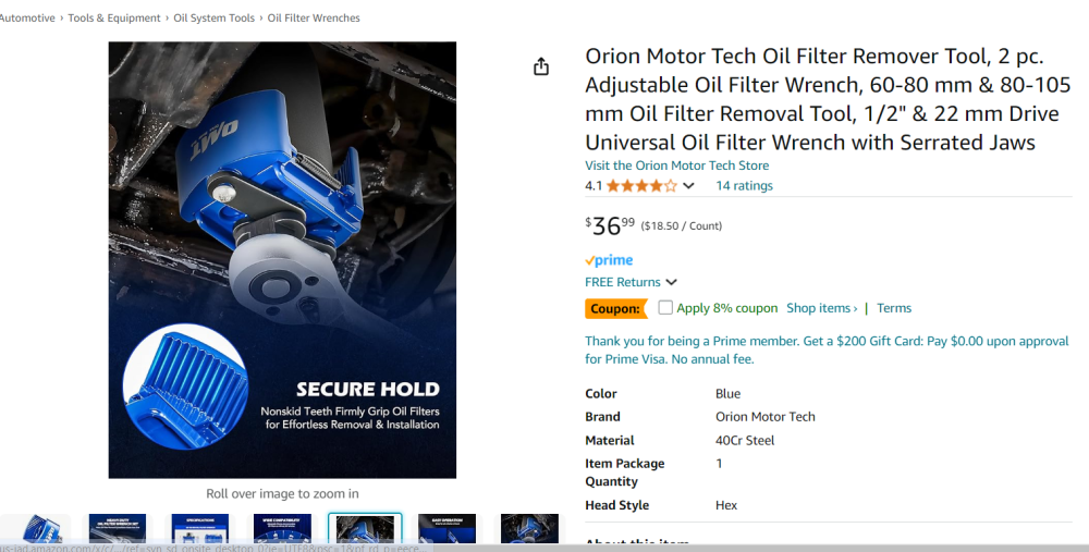

Suggestions? Looking online I see suggestions for end cap filter wrenches that are suppose to grip well. Brand suggestions?

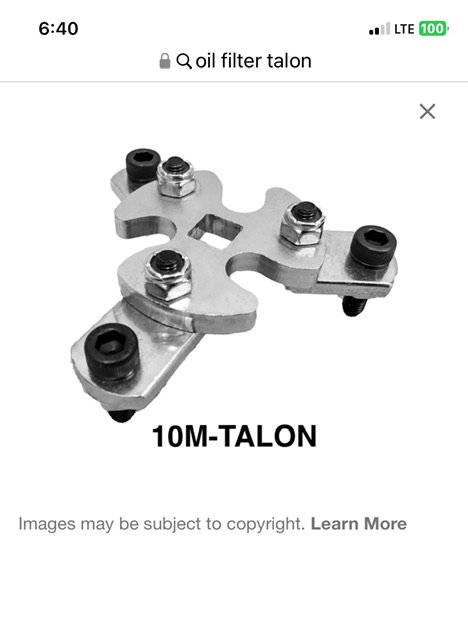

If the filter canister tears loose from the base, then You have those slots that fluid flows through to use a nice adjustable spanner wrench on, or, use a chisel, get a good notch started on the edge then use a larger size punch and using the chisel notch for grip, drive the base around until it spins offt by hand/
Thanks. I did see a YouTube of a guy suggesting the controls wiggle for a kubota mini excavator for relieving aux pressure to plug in hoses. Watched some reviews on filter wrenches. If it comes to the base only I saw a tool called the filter Talon.
The filter itself is heavy and smooth round on end not the kind with ridges or flats. The canister is thicker than a normal oil filter. But yeah, sorta worried about chain wrench crushing. Strap wrench can also tend to dent side. Will take care. Thought about trying to put something under chain wrench. In my minds eye I think of taping some wide cushion “feet”under chain but not sure what.

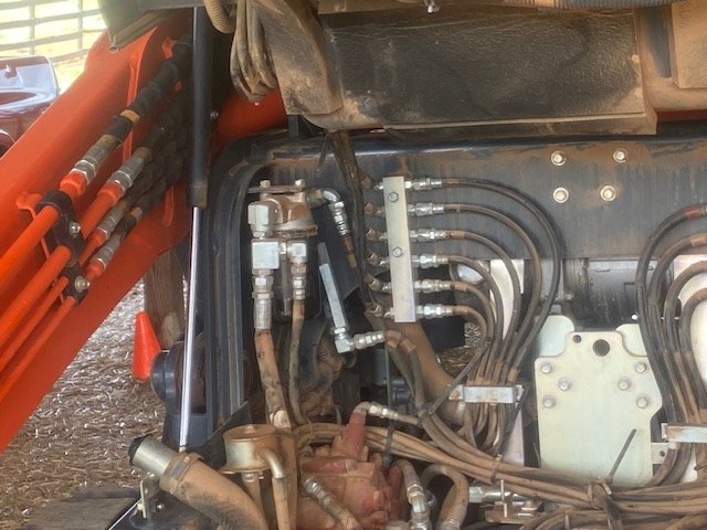

I guess luckily, it is a remote filter head. I can remove mount in a vice then cut dremel, grind, pry, chisel off. Hope it doesn’t come to that.

The hydraulic system has 3 filters 2 in tank 1 paper filter (this one). It might be on some forced recirculating cooler loop that is on a holding system or checked loop?????? The 75-3 hydraulic filter has a welded? nut on bottom of filter can. Probably had some complaints.
Well I'll say it was on tight. Not likely to get this filter off with avg filter or even really good oil filter wrenches. It took some real torque to get it off. I floated the bucket and it did not seem to be under any pressure.

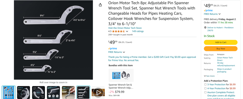

We ended up using a different brand of hook spanner, OMT, with a 3 ft cheater on it while also using an end cap style wrench with 1/2" drive telescoping ratchet. Two people torquing it off and it loosened.
The large red handle hook spanners didn't seem to fit as well and although I think it was an ok fit it just didn't bite as well as the large OMT adjustable hook spanner. The large OMT spanner seemed to get a cleaner torque on it.
These filters compress an Oring and tighten till metal to metal contact. Its not like an oil filter square-ish gasket.
There is no real way to tighten the new filter with a spanner wrench either need a good strap wrench or end cap wrench. It was a PITA.
