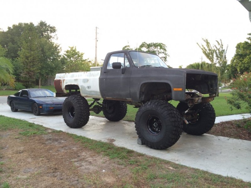

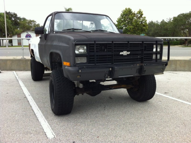

Truck V2.0 in progress.
Goals are to build as fully capable, durable and reliable as possible adventure truck for less than the cost of a used stock Duramax truck. The Idea being able to drive to the mud pits and kick ass all day and drive it back home.
