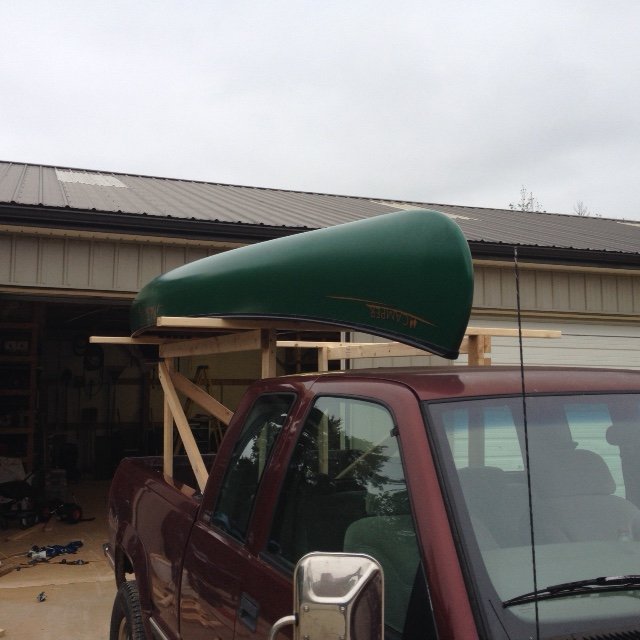

You shouldn't have to worry about this but one thing to watch out for in general carrying canoe's is any curve to the bow or stern lines needs to clear the roof of the truck when on a ladder rack type carrier. I built a wooden ladder rack that was a little higher than most for a canoe with a lot of curvature (think its an older ole towne Guide canoe).

Took me a while to find this picture. I made this rack for a weekend camping trip a few years ago. I wish I would have made it out of steel. Even tieing canoe to the truck bed with lots of rope and ratchet straps I still don't like trusting a wood rack but I was in a rush and this was my easiest option at the time. A plain headache rack would not allow it to clear the roof while upside down and that is how I like to carry them. You'll want enough clearance so when you pick up the rear end it doesn't see-saw pivot and scratch the roof of truck.
It is an older Old Town Camper canoe ~17 ft and the ends curl up a good bit.
