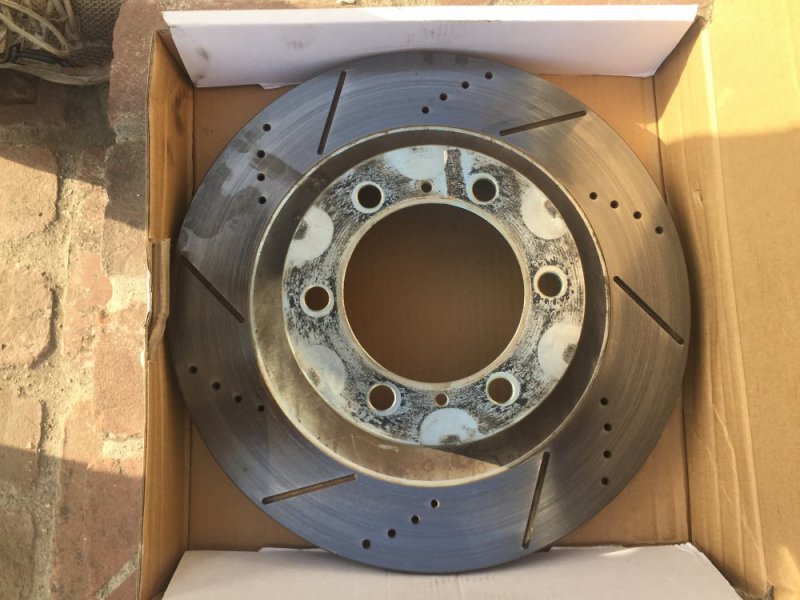

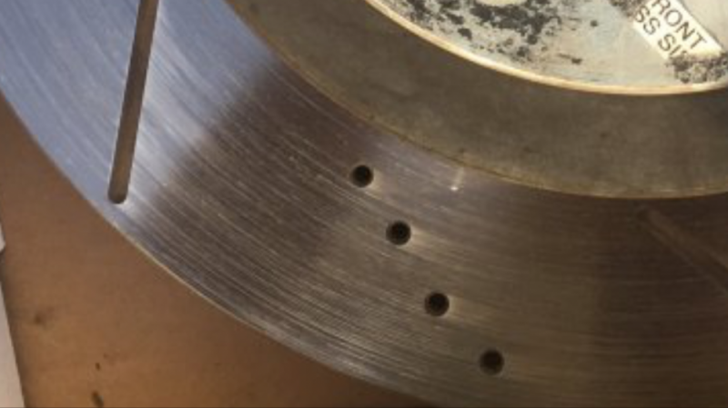

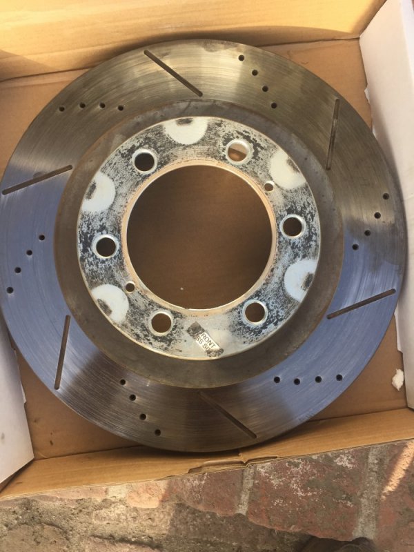

Put the new rotors on this AM. Some pics of the old ones.
See the difference in color before and after the slot? Then again before and after the holes?
This is the build up of pad material to rotor. This amplifies the concentration of heat and the problem is cyclic.
I'll see if I can find something to better describe it
