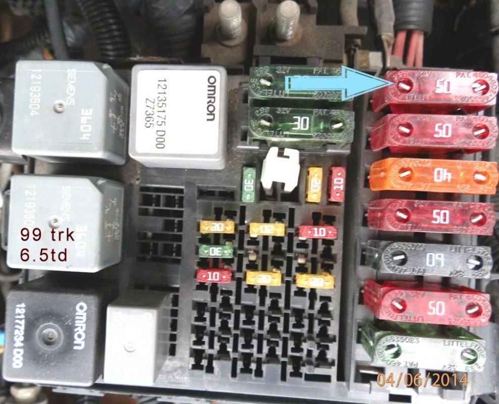

First time it happened was when I realized that the PO had installed one fifty amp thats the furthest to the back in the under the hood fuse/relay box.
Installed 30 amp units whats called for in the owners manual.

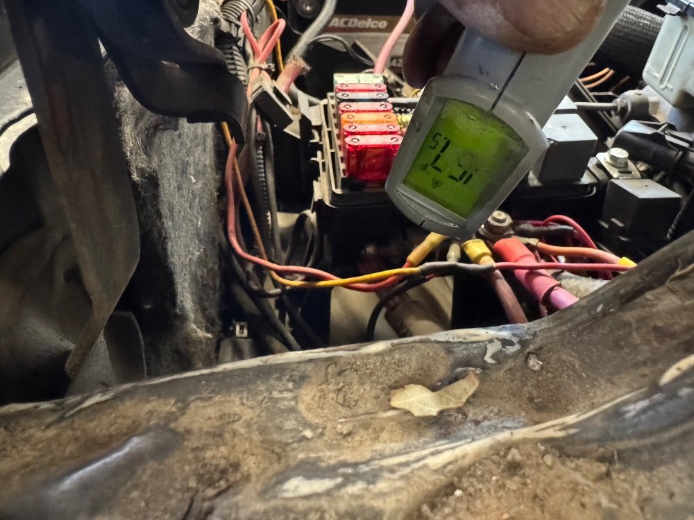

Main grounds checked and cleaned. They are bright and shiny, including the ground strap to the firewall, RH side.

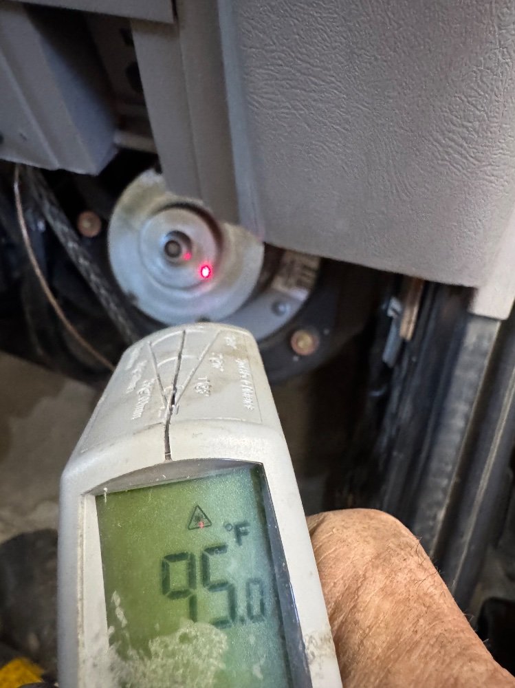

Blower motor off, engine running.
Fuse temp running 94*f.
Blower motor on high, engine running, blower motor running for about ten minutes.
Fuse temp 165*F.
IDK how accurate my IR temp gun is any more so not sure those are accurate readings.
That main fuse, WO blower motor running is okay to the touch, not cool but near normal skin temp.
After the motor has been running for a while, ten or fifteen minutes, that fuse feels as if it could near burn flesh.

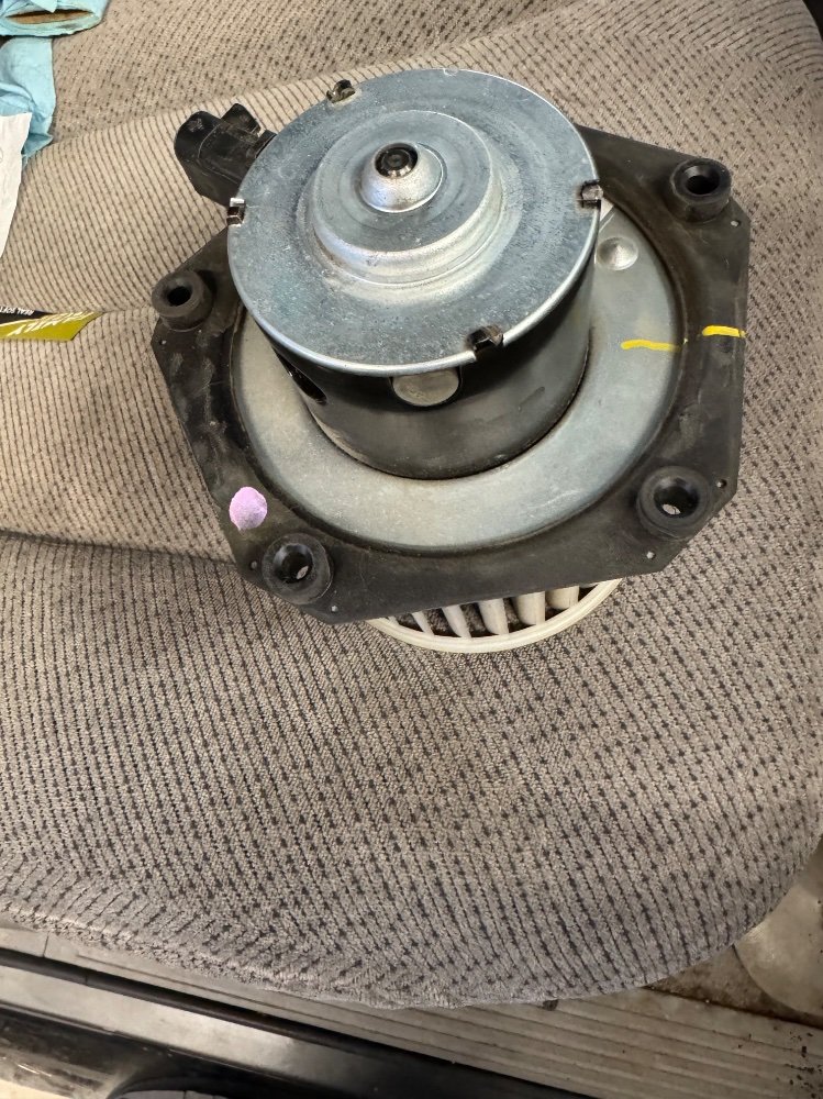

Pulled the jockey box to try and get a motor temp reading but there is this plasticated cover over tye motor.
Going to figure what it takes to get that removed, then, with it still in place, give the motor about a ten to fifteen minute run, pull that covering then get a temp reading.
Allow the motor to cool, even using some compressed air, then do a rerun and see what temp the motor and fuse runs at.

Motor winding housing.
Motor bearing end plate.
Fuse in fuse box.
The helper running the controls and barking out orders.
And now.

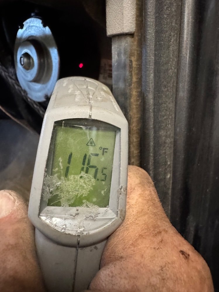

The motor winding housing at 116 degrees. That does not seem so bad, but IDK how warm they do run with the AC and heat off.
Now the strange part is, I can hold my hand on the motor winding housing for as long as I might want to.
That motor bearing end plate is so hot that within 30 seconds I’d have to pull my hand back, or, it would get so painful from the heat that I’d be forced to retreat or there might be the possibility of getting a bad burn.

If you look at that cover just right it will just fall off in a lot of pieces at least mine did lol sorry about your troubles man.
YUP, got it offt in one piece.
Pulled the ECM and the gizmo under it, along with the ECM mounting tray, then I could see and get to the motor wire harness/plug, then some more pulling and tugging and it came right out.

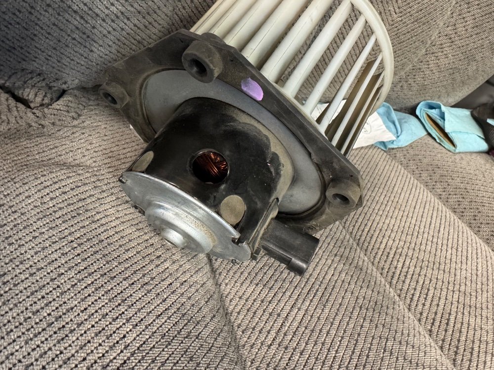

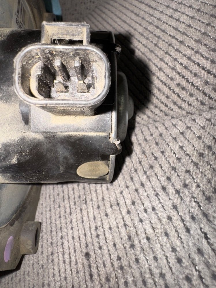

Looking at the motor terminals.
They all are shiny clean with no sign of corrosion.
Inside the plug looks dirty but the spade terminals and their counter components are free of corrosion.

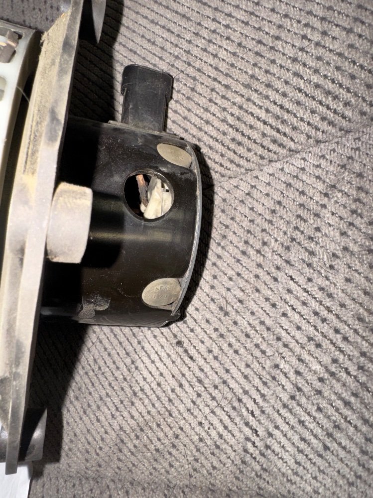

The armature windings all look fresh and clean. Dont know about the windings within the case, if there are windings within.
There is some carbon buildup on this brush connection wire.
I ohmed the terminals and the meter went to 0000 and maybe another zero or two.
Both terminals zeroed to the fan back plate.
I thought that one of them would show no continuity.
Now that makes me wonder that if I add a ground lug and wire if that will create a problem through the motor circuitry.
