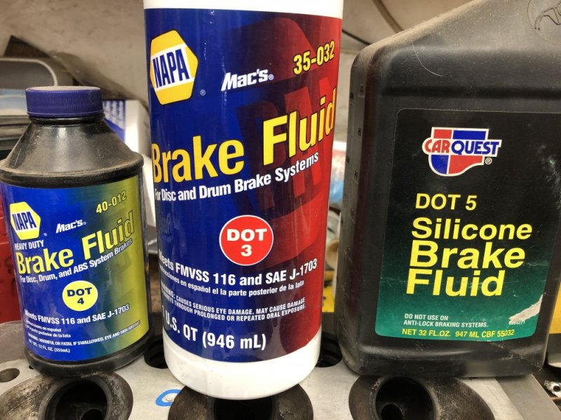

Whenever I do a total brake rebuild on any vehicle within My possession, it always gets the DOT 5 conversion. That information gets marked under the hood where it is visible.
If I would sell that vehicle, there is always a verbal warning, the painted on warning pointed out and a bottle of DOT 5 goes with the vehicle.
Not sure of the brand, most likely got it from NAPA.
I’ll try to remember and see what the brand is, tomorrow.
