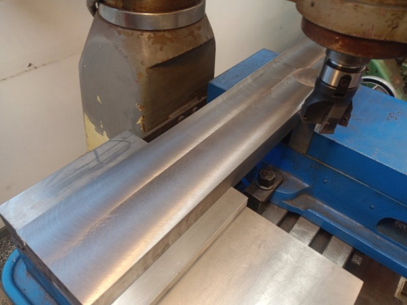

So as some of you may know I've been talking about this girdle for quite awhile. Well I'm finally getting around to starting on it. Don't expect it to be done anytime soon, I don't seem to get anything done quickly. Lol I picked up the cast iron I'm using probably a couple of years ago. Most of it is quite a bit bigger than the finished product, but in raw form it is pretty rough. My cheepee mill doesn't quite have enough travel to go full length so I have to slide it back and forth to do these long side pieces. Don't have a drawing but I do have a mental picture of how I want to build it. The piece on the mill table still needs about 3/16 taken off for thickness. It started out being about 1 1/2" and will end up being just under an inch.IMG_20220131_112838_470.jpgIMG_20220131_111253_561.jpg

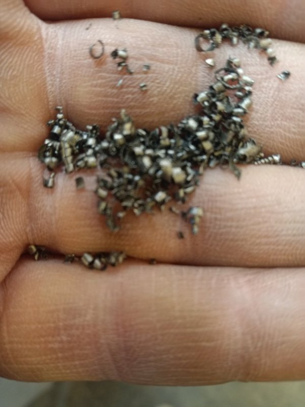

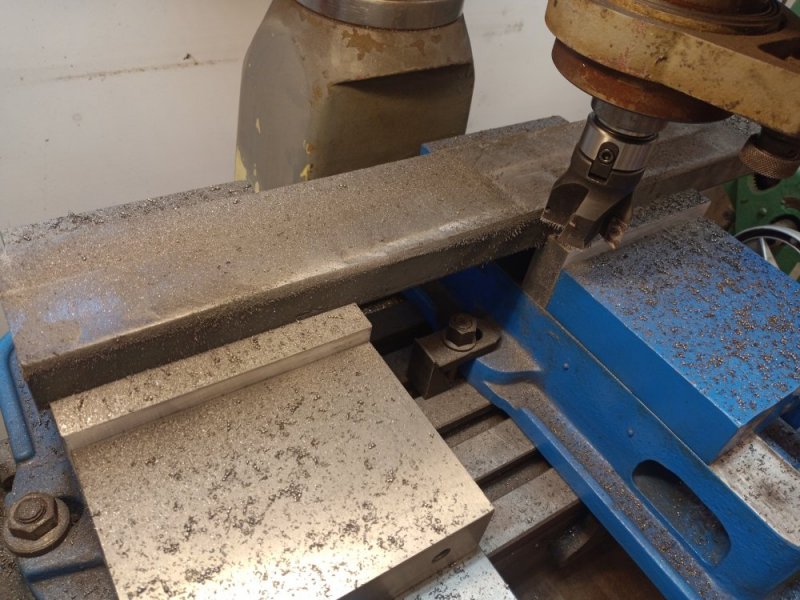

I'm able to make decent size chips, I keep flipping it and after a couple of passes I walk away and let it cool down. Not that it's getting really hot I can just tell by touching it that it's warmer than it was. Trying to keep it straight.....IMG_20220131_111535_724.jpg
So I have the first piece to the right thickness. I think the surface that goes against the block I might grind flat, haven't decided yet.

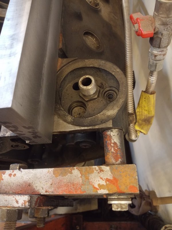

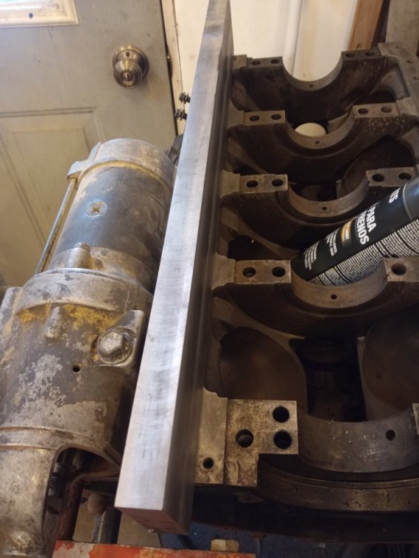

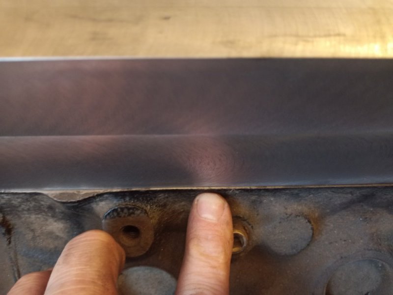

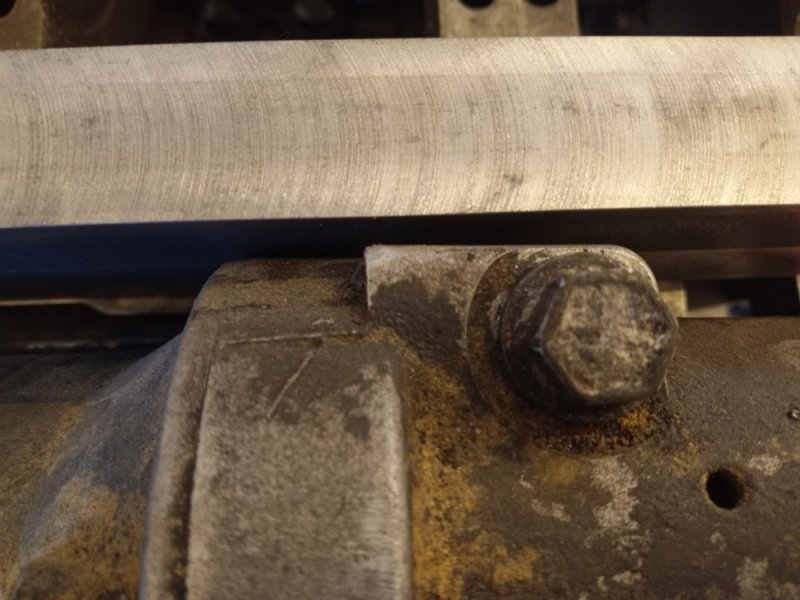

Decided to do a test fit on the block and as I assumed the rear of the block will have the most clearance issues.IMG_20220201_125229_293.jpgIMG_20220201_125235_615.jpgIMG_20220201_125254_843.jpg
I'll probably clearance the side rail to clear the starter but I'm going to wait and get a ball mill so I don't have any sharp edges to create a stress fracture.

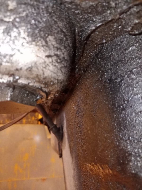

On the oil filter side I'll have a similar issue with the oil filter. I'm probably going to use a remote filter setup but I think I'd like to be able to use the stock set-up as well.IMG_20220201_130256_521.jpgIMG_20220201_130334_988.jpg
Here's how the stock oil filter adapter fits on my optimizer. If anyone has what they think would be a better idea.....
On the oil filter side I'll have a similar issue with the oil filter. I'm probably going to use a remote filter setup but I think I'd like to be able to use the stock set-up as well.View attachment 71419View attachment 71420
IIRC, when I had a dual remote filter, the adapter was about the same size as the filter.
Are you planing to mill the block main cap registers back to your new side pieces or step the new cap blocks ?
The cutter you are using could be used to clearance where the oil filter mounts, plunge down into the side for a large radius cut maybe.
