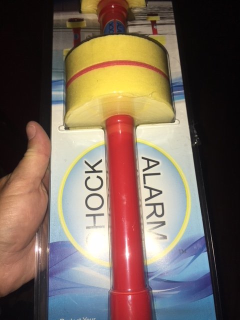

By the way the wife has already bought a floating in water shock alarm.
