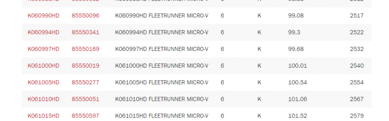

I like the idea of trying to prestretch a belt. They do tend to stretch some after just a little running.
Belts, hoses, and brakes should be high-quality parts IMO (don't skimp).
The 22105 part no. comes up as a radiator hose on my searches.
I have used Gates Fleetrunner belts with some success. They are supposed to be heavy duty with Kevlar threads.
(Hard to recommend parts anymore as a brand recommendation is time sensitive)
Also, for best results really clean all the pulley's especially the grooved ones with a degreaser, brush, and brake cleaner.
Belts are always a tad annoying trying to get the best length. IIRC the K061010HD (101.06") is a tad long.

Is that a 100.5" belt? I need shorter after the vac delete.
Nope, that's not even a belt part number...lower Radiator Hose...Boy do I feel stupid, looked at the wrong part tag stuck to the wall and I'm now out of town for the next few days. You're on your own boys.
