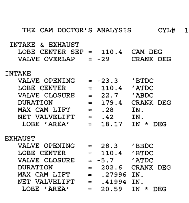

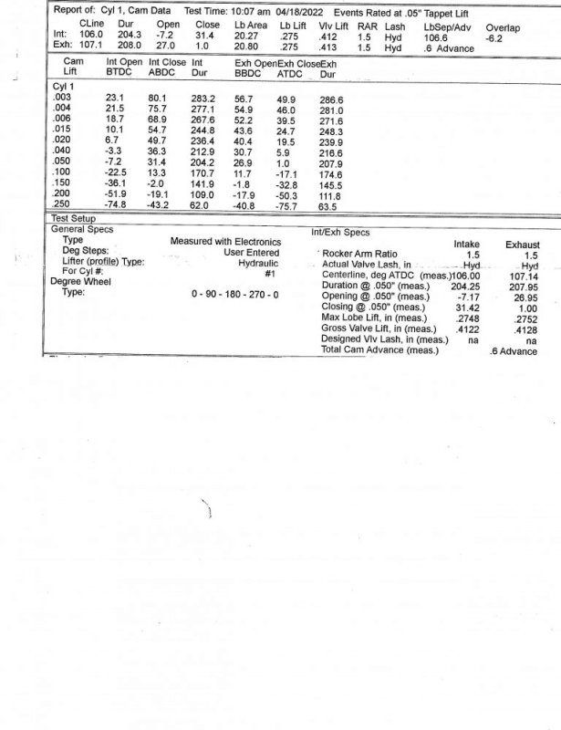

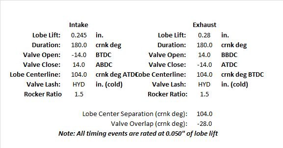

Twisted Steel Performance Anything worth doing is worth overdoing. Vendor Messages 4,393 Reaction score 9,003 Location Pauline, SC Apr 26, 2022 #45 Well I couldn't find anyone to make a billet stick, but I did find a place that would grind the stock cam to my specs, this requires new pushrods...
