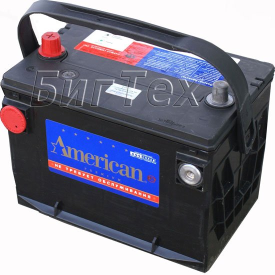

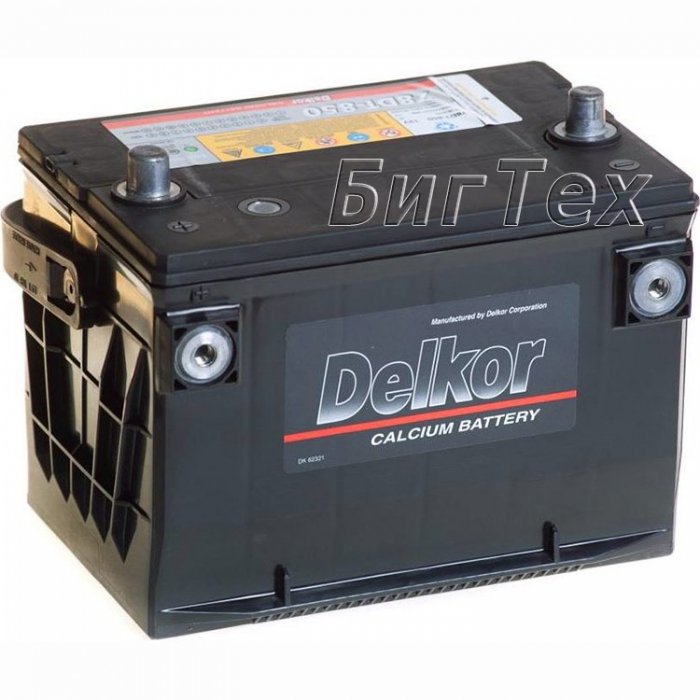

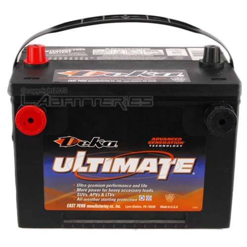

I use batteries, two connected in parallel. 78DT-850 95 Ah My batteries are "Delkor" brand, they are produced under the "American", "Deka 778DT" brand. They are not serviceable, they do not have a plug for draining and filling the electrolyte. If you have a choice, buy a battery with plugs, you can increase the density of the electrolyte for winter work.
