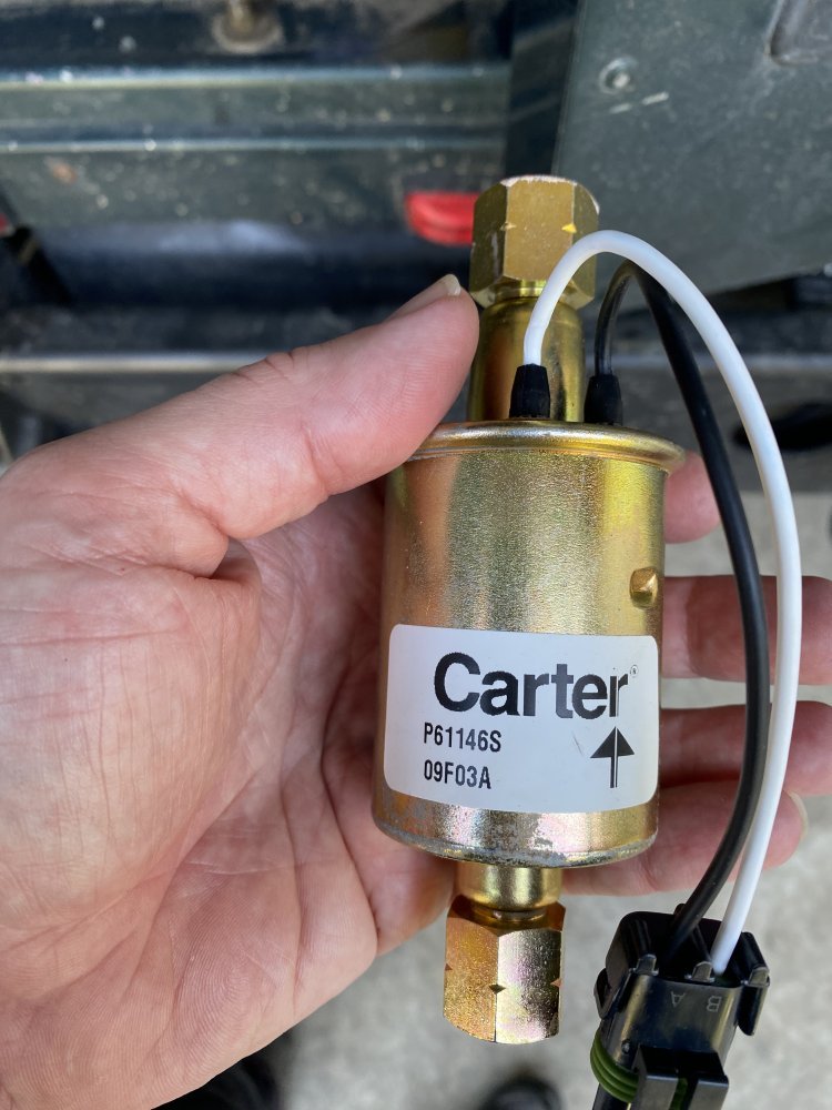

Yeah, so long as you verify where you get it from is real, that’s what’s needed. It sounds familiar about the AC Delco store on amazon but iirc there was another store that was similar named and they were trying to shut it down a few years ago.
So that’s why I say verify. A four minute phone call is worth it to avoid the knock offs.
I remember back when I was chasing this years ago RA was not authorized dealer at the time for AC Delco, If they have become one since then, great. They weren’t for Bosch at the time either, which is why my destroyed piston didn’t get covered & Bosch wouldn’t even accept the glow plugs to examine if they were theirs or cko.
As to which LP- after watching people run them for years and having the pumps just never seem to fail, coupled with the best filtering system out there- thats why I say Fass. I’m sure there are others that will do fine cost less but maybe just not last as long. Which ever LP floats your boat is fine, just get the gauge so it is taking the reading at the ip inlet via all metal connection so no hose is after the tap is the big thing to do. 8-14psi range for the ds4. One of the guys on the hummer forum made his pump controlled via dial and could adjust his pressure by turning a knob, iirc he said 11psi seemed to be the sweet spot for power.
