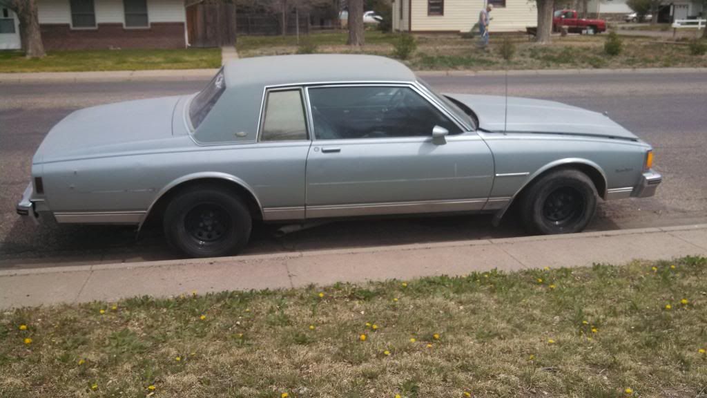

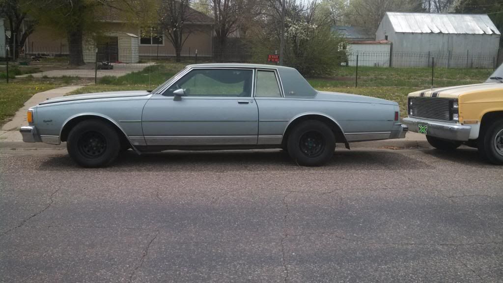

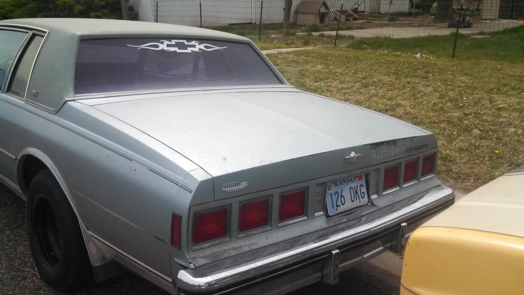

Basically he had it, sold it to a guy, guy's kid noticed GM bean counters skimped on head bolts allowing the head gaskets to fail, and gelled it up, possibly ruining the IP.
valve covers and intake are off, and that is where he quit, because he is under the impression that the pan needs dropped to pull the oil pump driveshaft to pull the vac pump to pull the intake to pull the heads. I dont know for sure, I wouldnt think that GM would screw up that badly, but who knows.
I'll try to get some pics.
I guess by being an 82 it should have the DX block with the roller cam, so its much better than having a 78-80.
