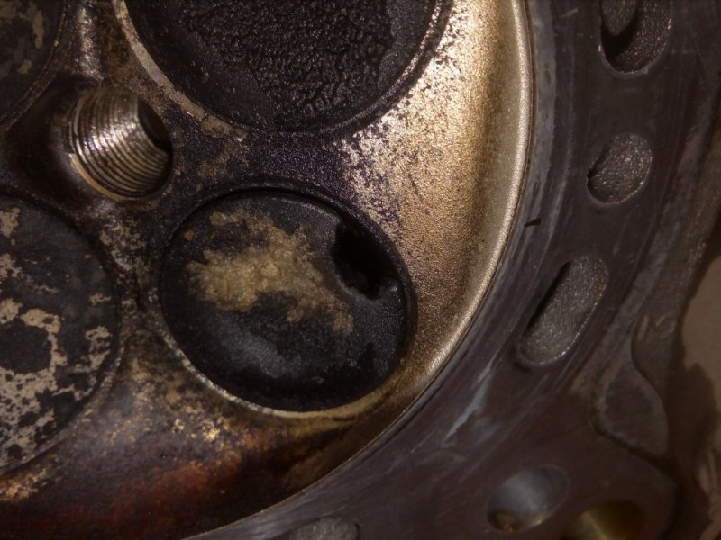

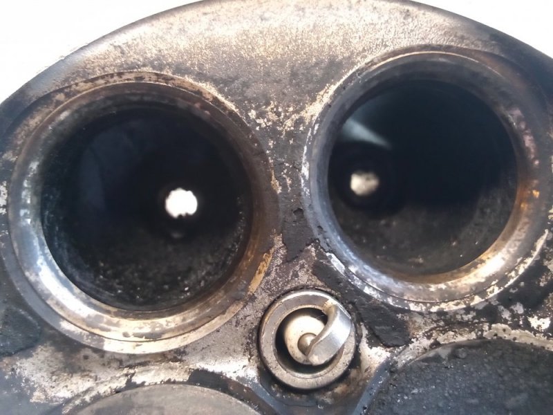

So I decided to start a thread on this engine in my wife's car. It's a 2004 Acura MDX. I originally paid $700 for it and had to fix the engine with a burned valve. That was about 3 years ago and 80-100k miles ago. Well here I am again with a burned valve, interestingly enough it's the same cylinder.IMG_20220504_122324.jpg
So part of the reason I'm posting this is I'm looking for ideas as to why the same cylinder. Someone suggested possibly a slightly out of spec injector, which has some merit in my mind. It would have to be pretty small difference to last 100k.
Also before I broke the head bolts loose I dropped the exhaust and about a cup of antifreeze came out of the pipe. Currently head is at a shop being pressure tested. No obvious cracks to be seen and it wasn't using antifreeze before either. Kind of a head scratcher for me.

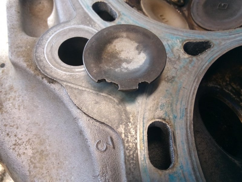

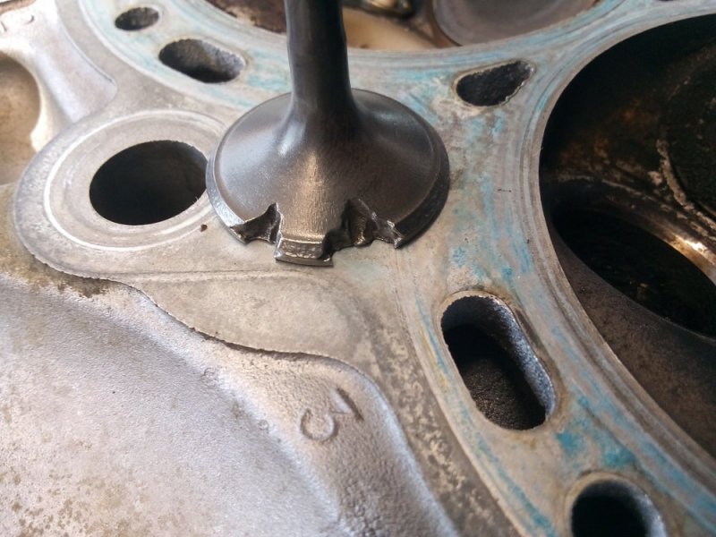

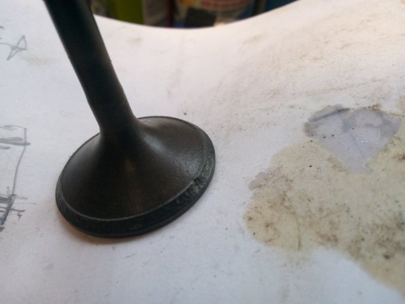

So here's the offending valve. I'm kinda wondering if there was some carbon build up between the valve and the seat. There was/is quite a bit more carbon in that cylinder. Hard to tell how much is from when it started running poorly though.IMG_20220510_141934.jpgIMG_20220510_141952.jpgIMG_20220510_142002.jpg
This picture of the valve seats was after I scraped it fairly clean

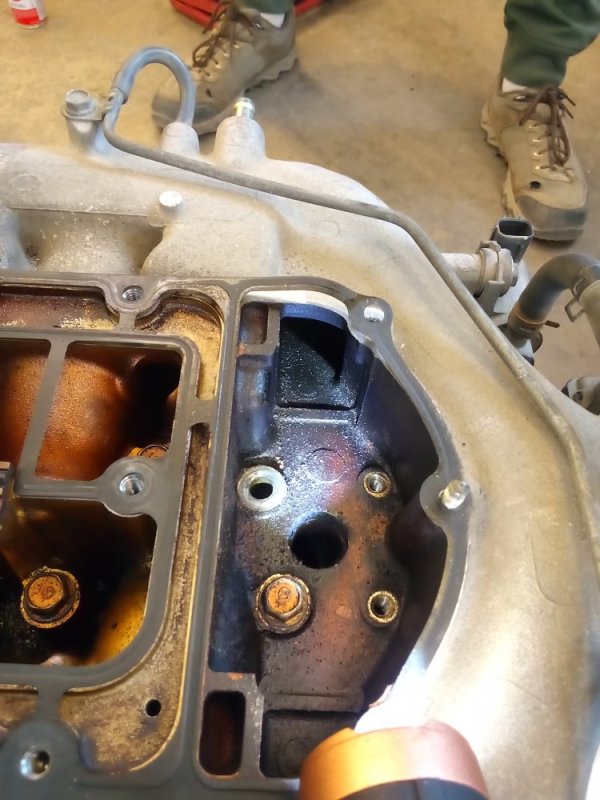

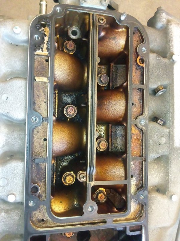

So there is 6 holes on the top of the runners but as far as I can tell they're sealed by the lid and gasket.IMG_20220511_170940.jpg
At the throttle body end is where the EGR comes in and there's a diverter there that splits it in two, one for each side. It appears to just go into the main runners before breaking down to individual runners.IMG_20220511_170910.jpg
So I guess my system must be different than others. Watched a few vids and a lot of others had channels in the lid to direct flow into those holes my lid has none. Just a contained area with a gasket all the way around the holes so essentially a dead area.

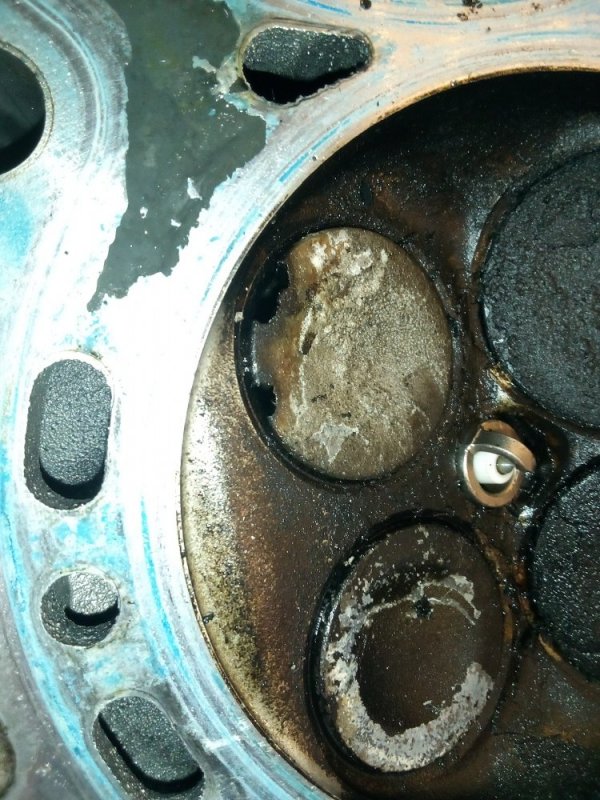

looking at the pitting on the other valve seating area, how are the other valves? wonder if this is from the ethanol that's in the gas nowadays. or something causing too hot of a burn like you mentioned, an injector not atomizing and squirting a stream of fuel directly to that area in the cylinder.
an easy test on the injectors you can leave them in the fuel rail, they should have a keeper to hold them in place. let the fuel pump run and then connect 12v + and touch the neg momentarily to make them pulse one by one watching the spray pattern.
