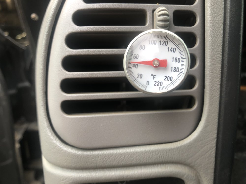

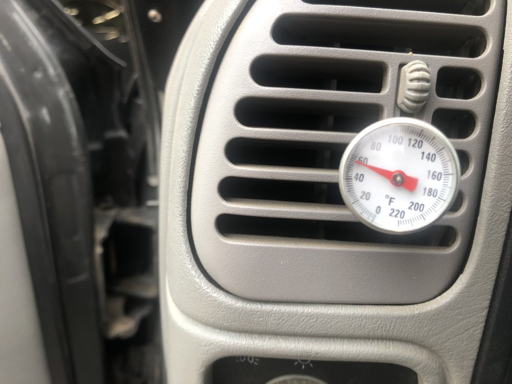

Okay. Finally getting back to the AC conditions.
The ambient temp, according to weather apps is about 75 degrees F.
When the AC is set on the fresh air mode the compressor clutch does not cycle.
Engine idled up to 1100 RPMs and AC set on MAX and fan speed on high.
And the thermometer.
I sent the videos to a friend that is more AC savvy than myself.
He stopped over at My house.
Watched the compressor cycle several times and said it is working most excellent. What do You think is the matter ?
I responded that I was wondering if the compressor cycling so often is normal. He said yes, thats just how they function.
Okay, I guess it is all good.
I am going to get that dual sided high pressure switch and install it though.
