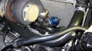

While researching Quick Spool Valves, I found a neat alternative that some people have done. It's not really a bolt-on, but it should be cheaper than the ready-made QSV that is available in the aftermarket. I've already been considering making a different exhaust header arrangement for my setup so this may be a cool addition to that. Regardless of whether I do or not, I thought it was a cool thing to share with you guys as a thought provoker.
So when the wastegate is closed, it would force all of the exhaust gas through just 1 scroll of the twin-scroll turbine housing which would cause the turbo to spool up much quicker. Then when the boost is high enough, the wastegate would open which would allow the exhaust gases to flow through both scrolls of the turbine which would allow the exhaust gases to flow through more easily. You could even control this to open on the highway for less restriction and use an oversized turbine housing. This is just another way to accomplish what @6.5L did with his QSV A-Team installation. It may be cheaper, but maybe not easier....I just thought it would be good to share. Plus, who doesn't like more turbo porn!!??

No you wouldn't want to seperate the flow from half the engine. You would want all 8 cylinders to feed a common plenum but at low boost all the flow would go through half the turbo to get it spooling faster and then once spooled all the flow would go through the whole turbine to take advantage of the flow capabilities.

The QSV will only work with a twin scroll housing, so having a QSV butterfly when it's open is no different than the twin scroll housing. And the shaft doesn't really sit in the stream of flow for that reason. Also, the butterfly doesn't sit perpendicular to flow. The way it sits closed, is around a 45* angle towards the open volute, to promote airflow towards the open volute when closed. It really is a good design. As far as wastegates, something close to a open butterfly would work, similar to an exhaust brake in the downpipe type design. Another thing I may suggest is actually swapping turbine housings. For $265 I got a wastegated 14cm housing for my HX40 and all I can say is wow. It may actually give you a boost in performance compared to the 18

What side of the turbine you throttling? The big diameter or small diameter? The BD QSV throttles the big diameter of the turbine as @6.5L and I installed it. So I suggest your 2nd picture is different by spooling off the large diameter. I would suggest sampling the engine oil at 500, 1000, and 1500 miles to make sure the exhaust restriction of a spool valve isn't ruining the engine oil. Non-coated 6.2 pistons I was using may have been a major factor in killing engine oil with the QSV. The 90 degree bend may keep a higher average restriction, but, in context of the two 90 degree ports GM left us on the passenger side the bar isn't that high to start with.

Oh that picture wasn't anything I put together, they're just pictures I found on the interwebs to illustrate the idea. I agree, throttling the big diameter is the one that makes sense to me and that's how I would configure it.
