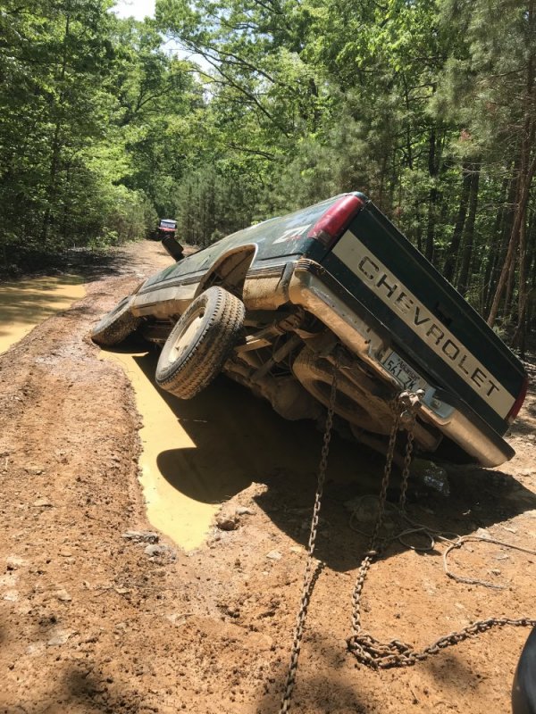

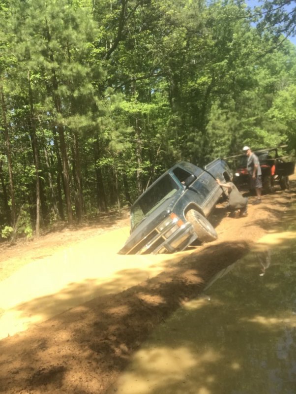

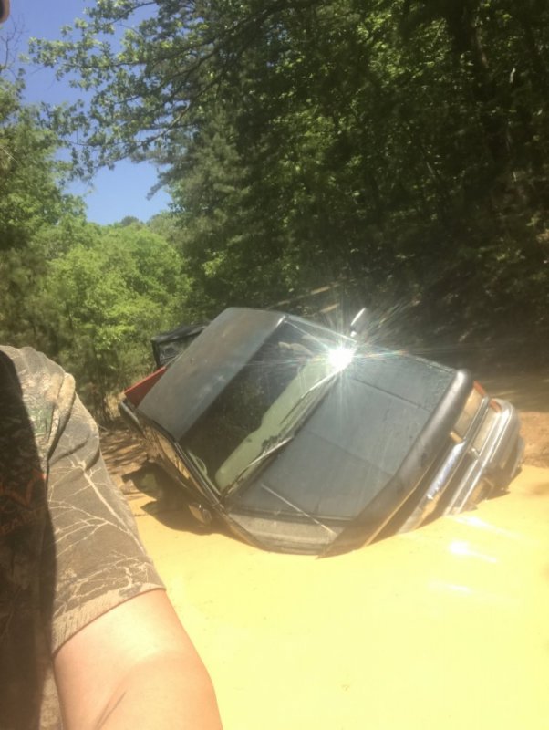

Hello my husband and I have a 97K 1500 turbo diesel that has seen better days (because of us) . This is our every day truck however we had a little error in judgment last week when going Turkey hunting and now we need a new brain for it. Had the sign been on the way we came we would’ve turned around.3D22F4EA-AFB7-4709-8174-0A716C8F0269.jpegD7D1653F-28D7-4BE3-B41C-00FE14E1406C.jpegF8A60154-9266-4610-B3C6-CB93A7F7C938.jpegD0EE662B-BF68-4872-B19E-B378EE44B5EB.jpeg

The front diff may be filled with water. Need to get the oils changed and things dried out ASAP. Check the air filter because as Will mentioned: If it sucked water the engine would have a bent rod at the minimum.
The electrical may need to be dried out. Alternator, starter... maybe connectors.
And I wouldn't expect that left front hub bearing to last. Deep water from monsoon runoff took mine out as well as the driveshaft center bearing.
Thanks everyone. I should mention that side by side in one of the pictures did not pull us out which we knew it wouldn’t but let the older man who was kind enough to try and help give it a try anyhow. It would barely budge when a friend with a 4wd dodge tried-took another friend with a 4wd Cummings diesel to get it out.

The starter is likely full of the water and mud. It likely isn't capable of spinning the engine fast enough anymore.
If these are flooded batteries ... the battery that was under water may have lost it's acid through the vents.
When things are under water the water replaces oil really fast.
A video of it spinning over would help. But if it sounds like it's cranking slow: it is and one is wasting their time trying to get it running.
