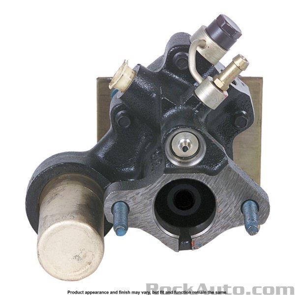

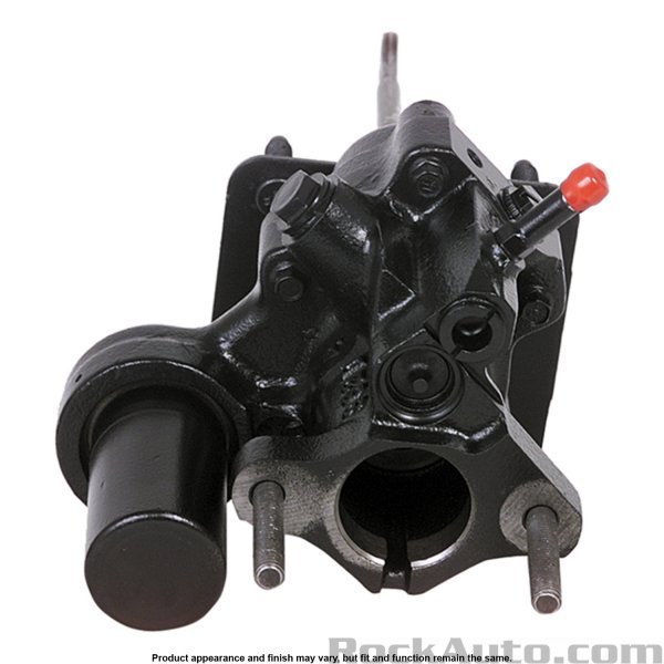

below is a couple of photos of what my original booster looked like and the reman one I have now looks like. notice on the first photo there is a tiny bypass pipe that my OE one had and the reman unit doesn't. could this missing piece be part of my problem?

on a curious note, the two boosted I posted a photo of... what is the difference between them or what is that little tube on the return port that my original one had?

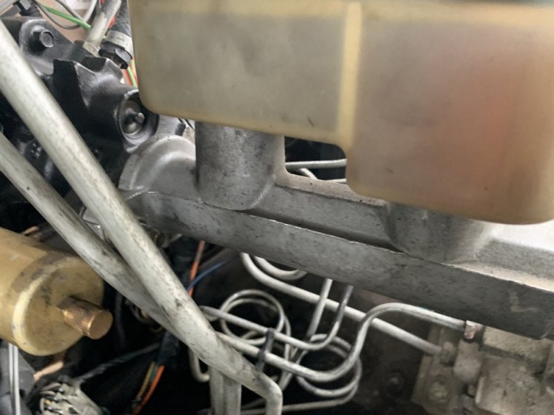

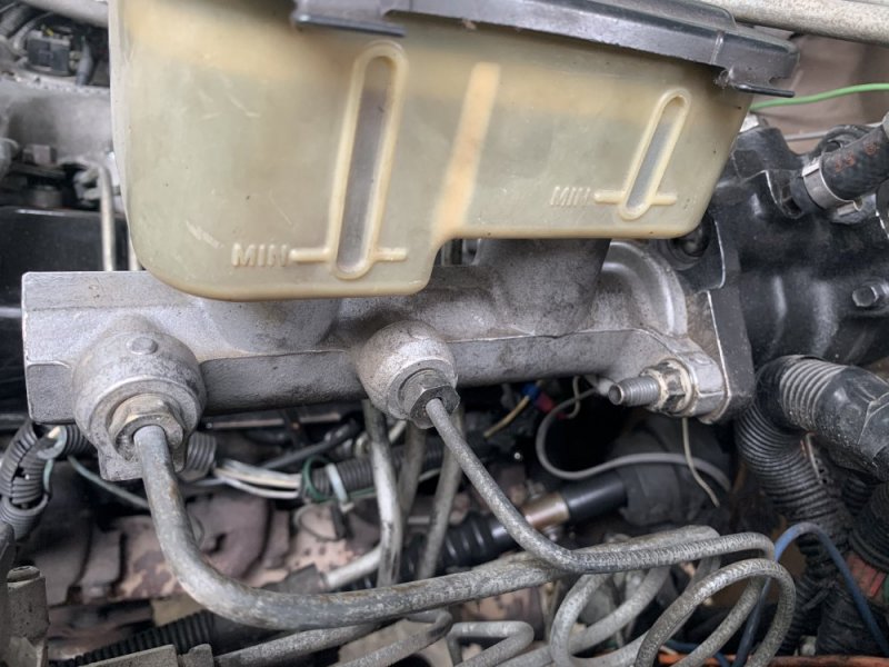

got back in the driveway and unbolted the MC and drew if back off the studs, used my handy caliper ruler to measure the bore on the piston. 1-1/4" or 1" and 8/32" on my ruler.
I found a number stamped on the front nose of the MC that reads MF 8212 but I can't really make out the "8" . I looked up the application on Advance Auto and they only show one that has the same size bore, but when you look at what other vehicles that same MC fits, it shows other trucks with 350 and 454 engines, nothing for 6.2 or 6.5 even though I entered my vin into the site.
the specs on JB8 shows a 1.312 bore MC. would anyone have a GM or AC Delco part number for the correct MC I could maybe cross reference to see what the specs are or see if Advance pulls up a different MC?
I'll post photos of the MC with my phone in a second. maybe someone can make out what the stamped number is or ID it telling me some hope!
Just looked up by application on Napa and O'reilly's, Napa was the only one that shows an HD variation having a larger reservoir and a 40mm bore, but everything else I see is all 1.25" bore. I looked up the hydro boost on Napa's site just for the heck of it and there is also a different one between a C3500 and the HD. C3500 shows a 53-7336 (again picturing one with the little tube thingy mine had) and for the HD version a 53-7338 booster (picture looks the same as what I have now without that tube thingy on the return port)
What gives! now I'm real curious if I screwed up replacing the booster with a reman and not getting one off a junker and rebuilding it!
