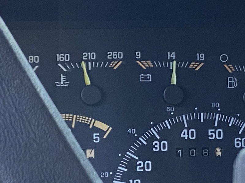

IR temp gun aimed at a lot of things as @NVW is my first concern. Not the first engine/transmission/etc. removed and replaced over a bad gauge or temp sender.
Don't care about accuracy as much as temp differential and what's hot and not.
200 isn't much over the "full open" of a 190 degree T-Stat. This is why the lower T-Stat and the lower temp KD fan calibration worked well.

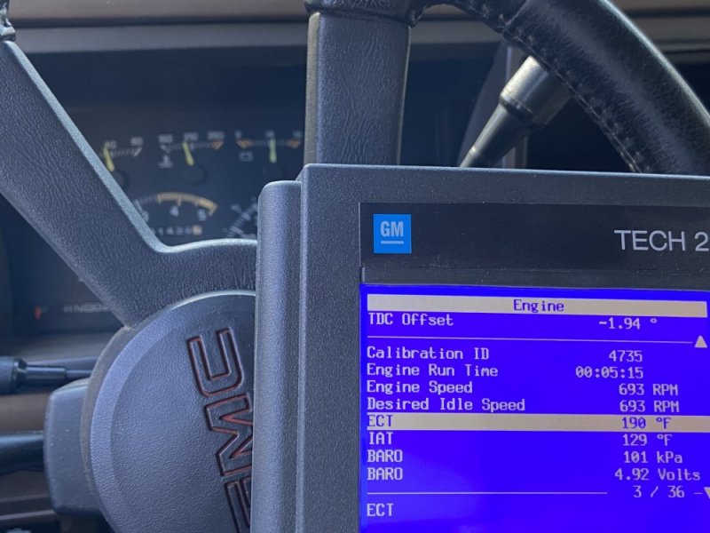

run it with the tech 2 connected, put it under a load for a bit and watch the gauge and tech 2. what I have done is since some person had previously been in the cluster, I opened up the cluster pulling the clear glass cover. set the cluster back in the dash. ran it to temp watching the scanner (GMTD) once it settled at a temp that wasn't changing I used a plastic fork and gently pried off the needle from the gauge and reset it according to the temp the scanner was showing.
I had to do this to all the gauges. the only one I have not verified is the oil pressure. I figured it was within range since it stays around 40 on the road and drops to 25 sitting still.
