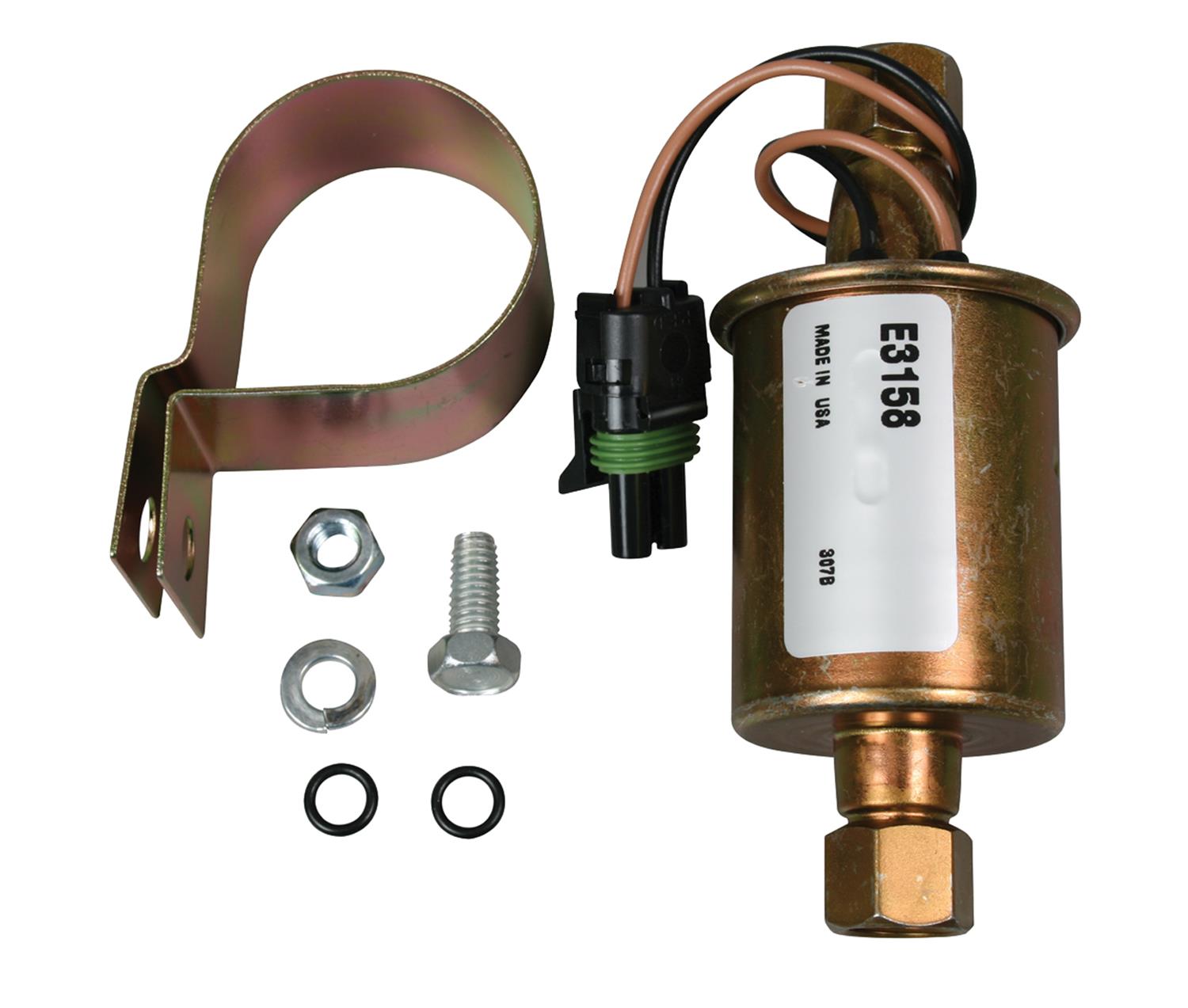

Where should I go to buy a lift pump? Prices r all over the place for ac delco. Thanx
if you plan to go factory OEM style part, use the ac delco EP-158. it's the better of the ones available. I have this installed on mine, but there are modifications needed to connect the lines.
There are many other aftermarket and much better options out there like the Air Dog, but it's a buy once cry once kinda thing.

Stanadyne I think for the ip. Don't forget I'm a contractor, not a mechanic, lol. All that sounds goods but I don't know how to do all that. I'm gonna do the clear line and change lift pump for now. I want a good lift pump, ac delco from where? I read a while back someone used a marine lift pump.
