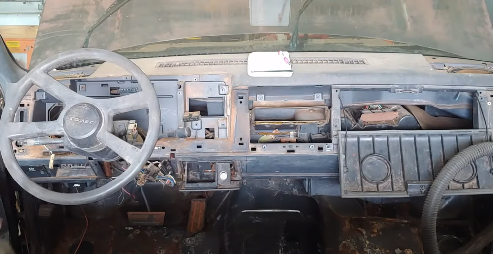

After watching several videos on dash removals I have come to the conclusion that I should be able to strip the dash down to the photo below (18:20 mark on the linked video) where I can lay some woven fiberglass cloth and resin over the entire top section covering the cracked areas. before that, using super glue to put areas back into place like the latch so they can be held while the glass takes hold.

Here is where I got the idea from to use fiberglass on the dash. in this video, the guy uses short strand mat and doesn't pull the bezels off first. those two parts I would do different. First by pulling and stripping all the bezels off and pulling the cluster and cluster housing out to expose everything that possibly can be fixed.
Is the top photo yours?
no, just a screenshot from the linked video. I have not had a chance take any photos of the dash yet. the dash is currently covered with a carpet glued to the top of the dash so the cracks are not visible, but the plastic around the latch on the glove box (dash side) had busted where the lid does not catch anymore.
