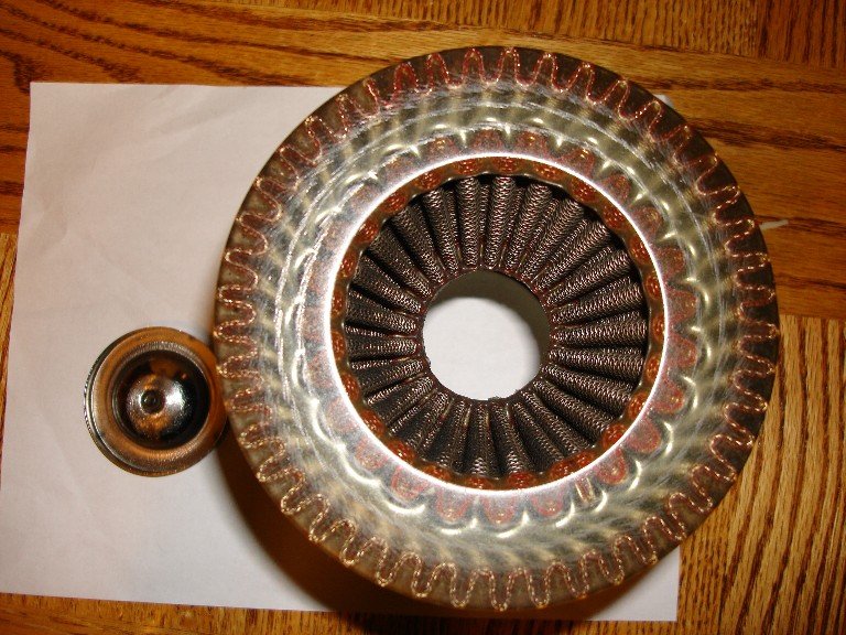

Long ago on a forum far away, before The TruckStop changed names to, well, The TruckStop.... Chasing a stalling issue for over a month only to find it was the Air Cleaner's Center Cap had come off a 1st Gen. SS Diesel filter and formed a perfect seal over the turbo inlet.
Unlike some unfortunates, it didn't hit the blades edge on and shred the Turbo. Just left pretty spirograph like etchings on the cap.
At least I ended up with spare OPS, PMD, Fuel Filter....
