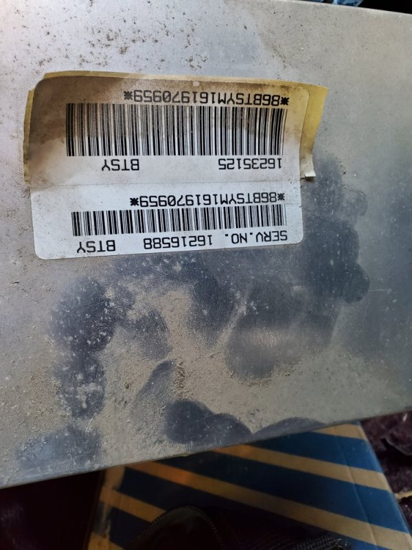

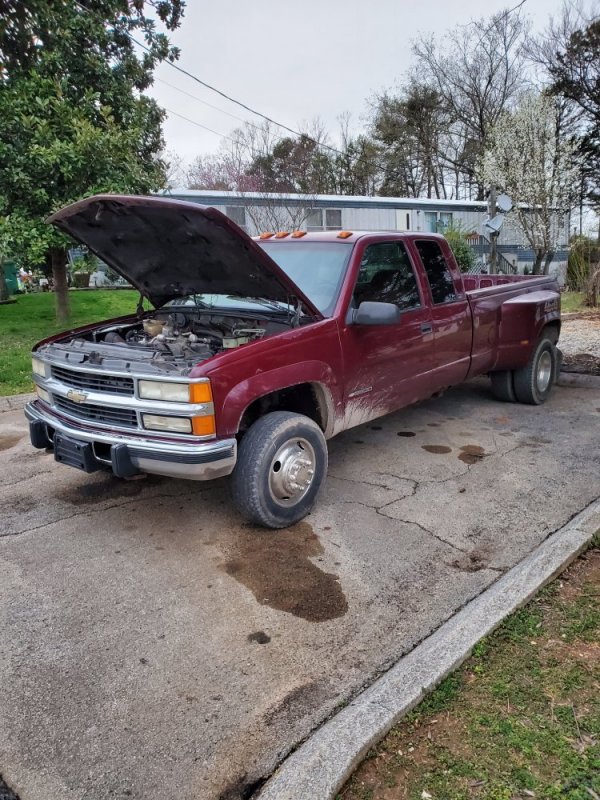

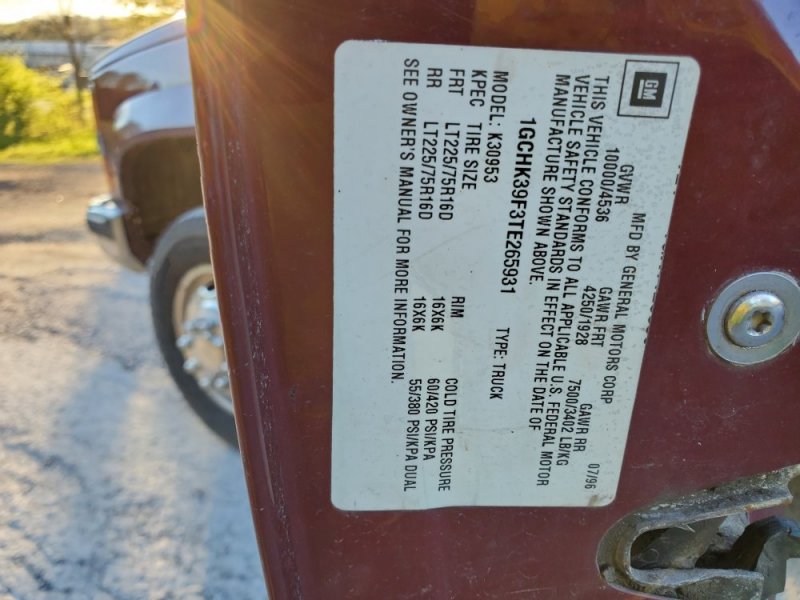

The problem I'm having is when I get close to 70mph it will kick down then back up on shift make the engine sound like its screaming for mercy and speedometer will drop down to about 65mph but feel like I'm gaining speed
