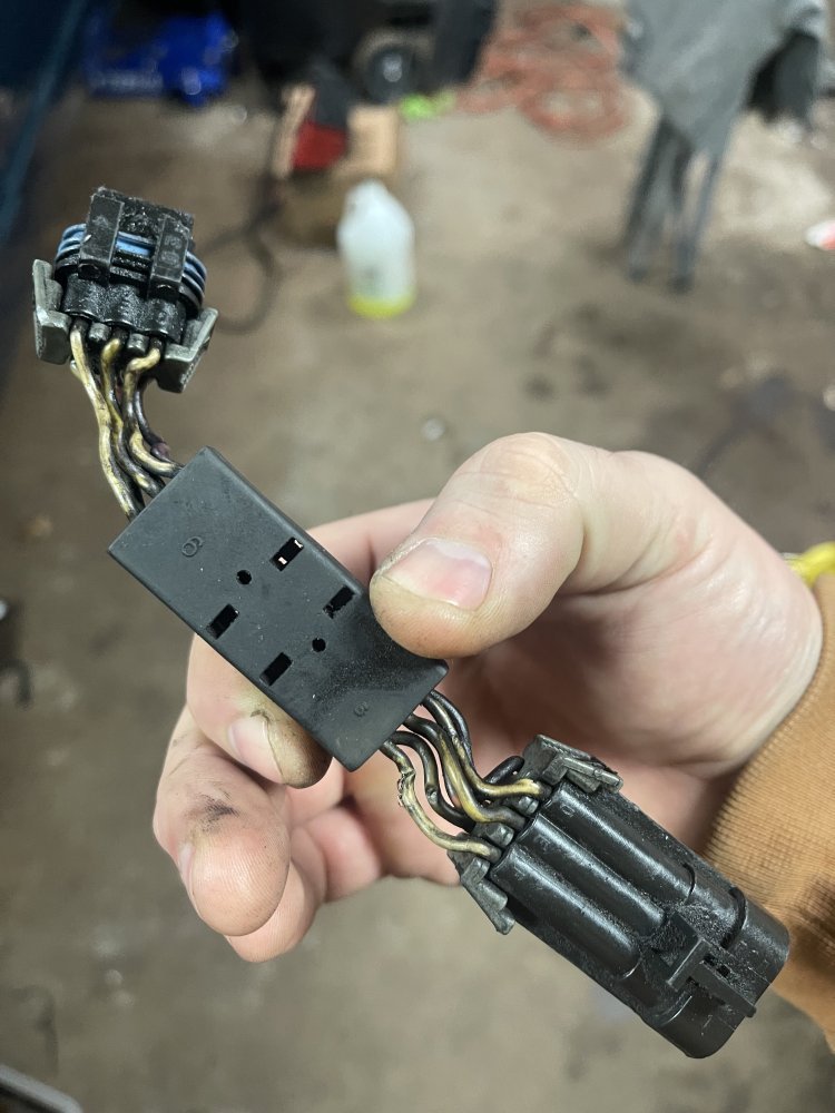

i have the pmd located on a heatsink near the fuse box
P1218 indicates a possible missing or failed PMD resistor. check to make sure the resistor is still inside the PMD connector. if it is, pull it out and use a ohm meter and measure it. also what # is printed on it? usually the put a #5 in from factory.
Is that what this thing is it has a number 6 on it
