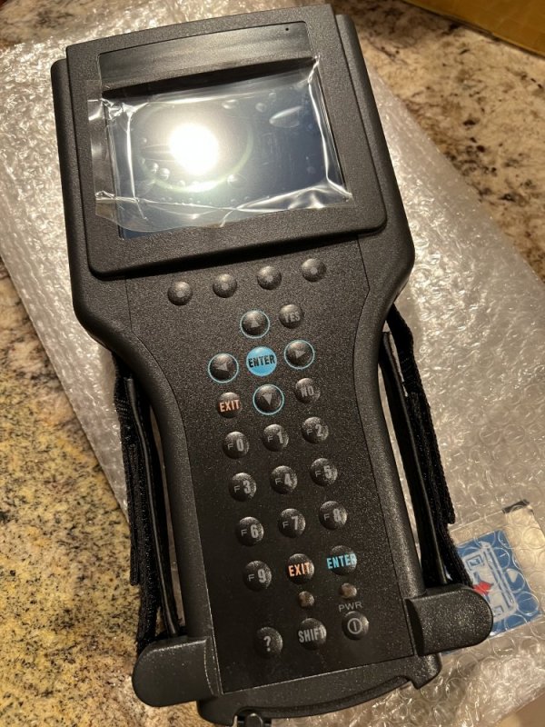

I bought a Tech 2 scanner I’ll scan it this weekend and see what I get

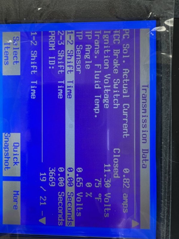

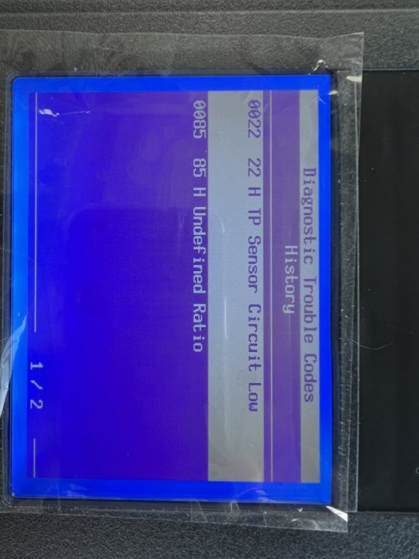

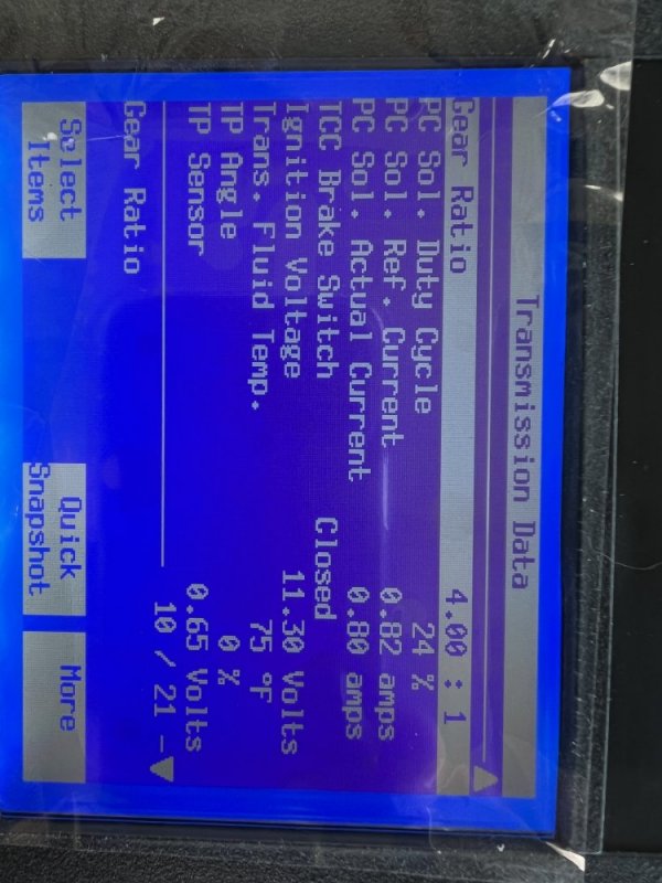

These are the trouble codes
WarWagon
Well it hits on 7 of 8...
10,142
6,847
You haven't answered my questions. Why did you replace the sensors on the side of the trans? Were they full of metal? Did you clean the grounds?
If the Code 22 comes back raise the TPS voltage to 0.6V. (Snapping the throttle closed may jar the sensor below 0.5V. Meter accuracy etc.) The Sensor may have a bad spot in it where it drops to 0.0V or a spot rubbed through the harness on the intake manifold.

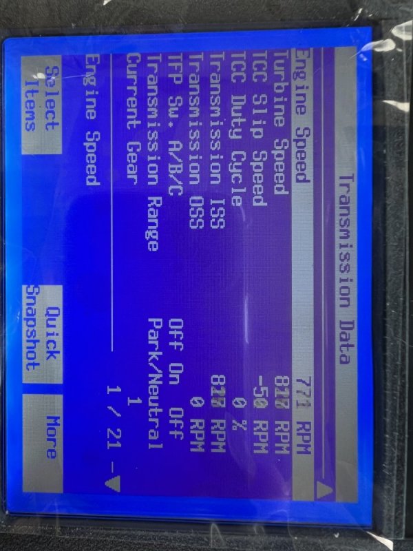

I suggest looking at Input RPM on transmission, stopped in park or N, engine at idle. Also output RPM. Again just in case the plugs got swapped. Then look at the RPM's while moving: they both need to read "Not Zero" RPM.
Otherwise Code 85 is transmission not shifting properly as commanded for any number of reasons.
I was told the sensors are a problem try and change them that is the reason.
