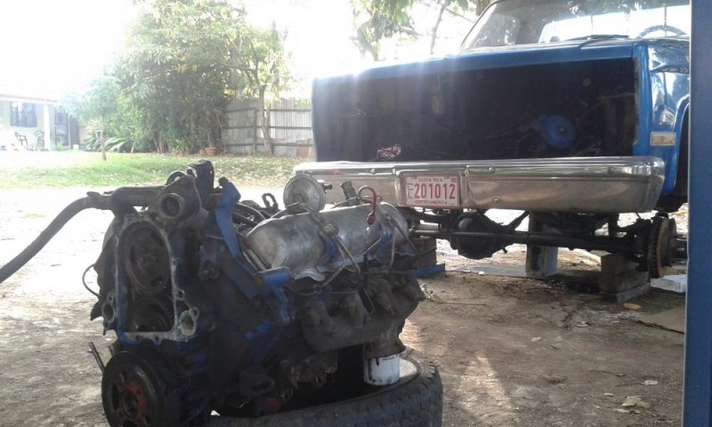

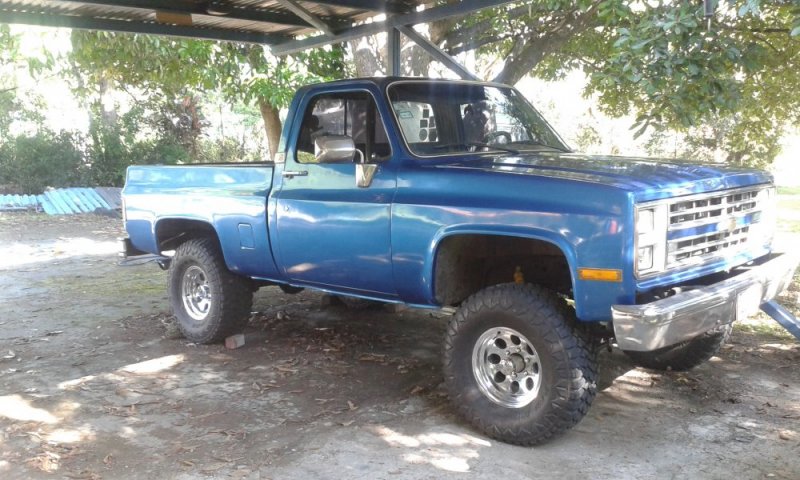

Hi everyone. I am a true beginner at fixing cars. I am trying to get this truck back on the road. A little history. Symptoms are smokes too much on cold start ups and smokes even harder under heavy load. Thick blue smoke all the time. Have to glow forever every start even hot. No cutouts or fishbiting. Power level ok. Started fine everytime with glow cycle. It would run good on flat ground but as soon as I would try to drive it up a long hill or idle in traffic the coolant temp would soar.
Tried first without a tstat and then with a new one. New radiator. New fan clutch. New temp sender. Nothing worked. Overheated every time so that ruled out the easier exterior parts.
Burns oil like a chainsaw. I was using about 1qt for every 4 gallons of diesel.
Bearings worn down to copper. The timing chain has enough slack to skip a tooth. So I took the leap and naively pulled the engine. The HG's had zero leaks. The coolant passages were clogged though. That could explain the overheating. Now I know I should have compression tested the cylinders before removing the heads but oh well too late for that now.
So that's where it's at right now. Engine on an old tire with the heads on a table. This is all first time experience. I am going by what I've learned empirically online. My question is what do I do now? Any advice, questions help, comments, criticism are all welcome and greatly appreciated. Thank you very much.
