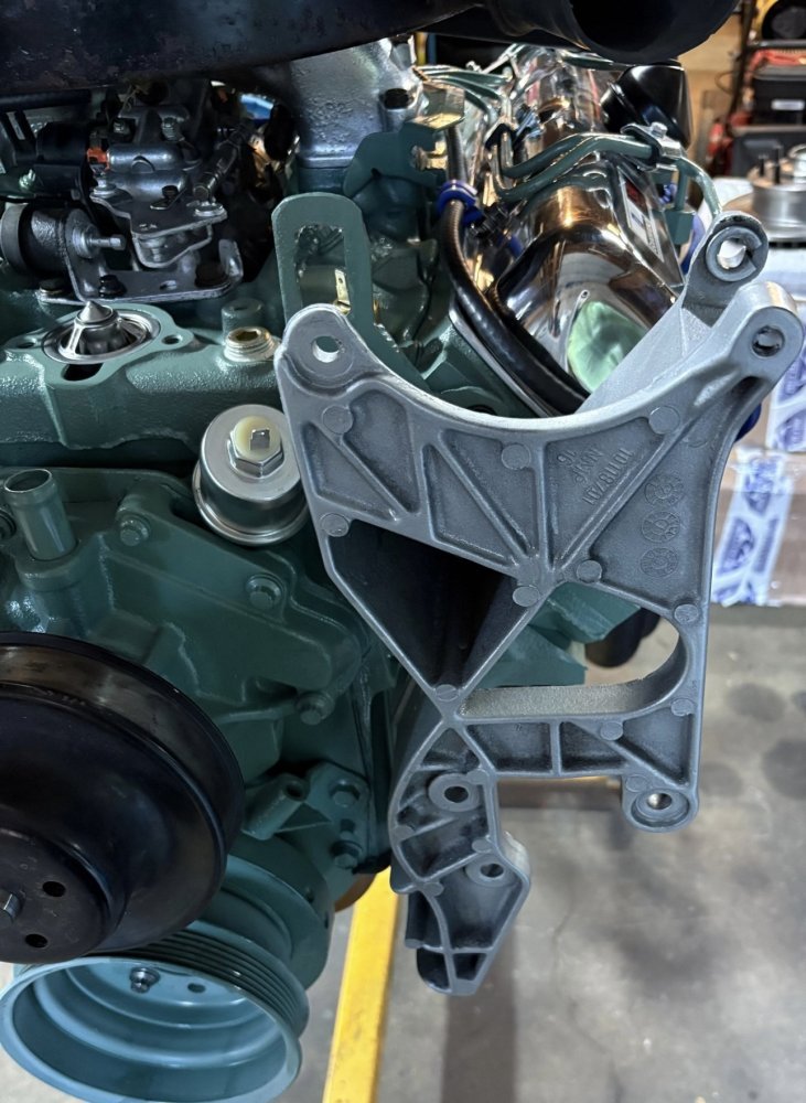

I think I have it figured out.Here’s how it sounds now.Its two videos in one basically.The first video shows no funnel in place for pouring in transmission fluid.Its also before I used the liquimoly diesel injector cleaner.The second video has the funnel in place and the liquimoly as been added to the tank with 5 gallons of fuel blended in.It seems to run smoother now.The injectors were given a clean bill of health a couple years ago but have been sitting until now.

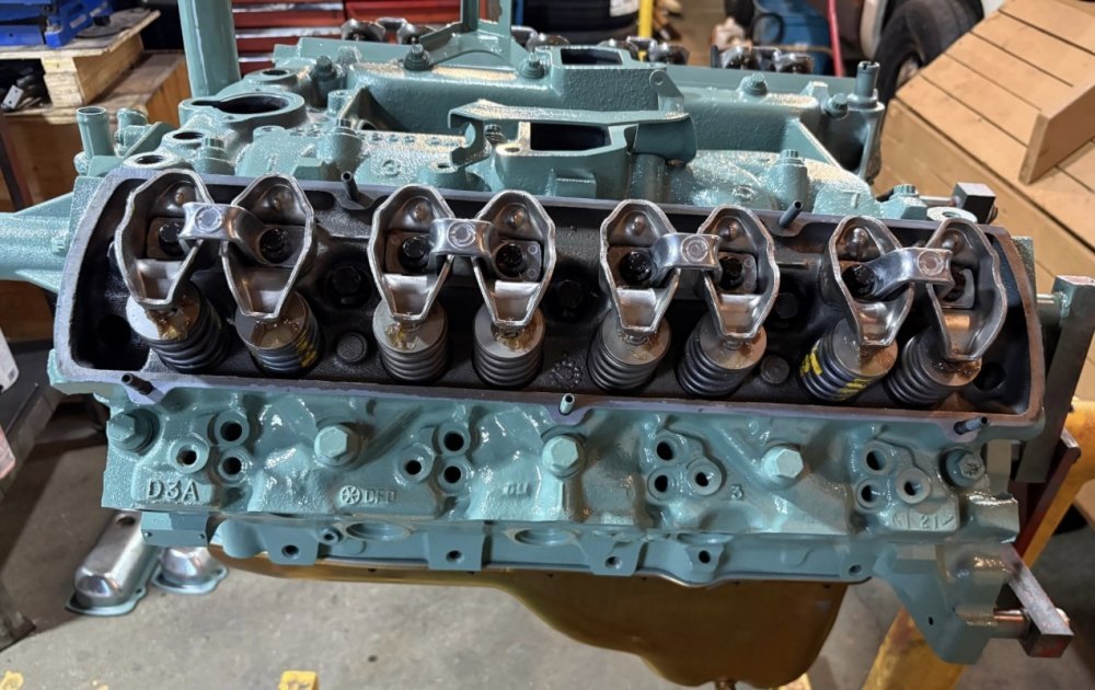

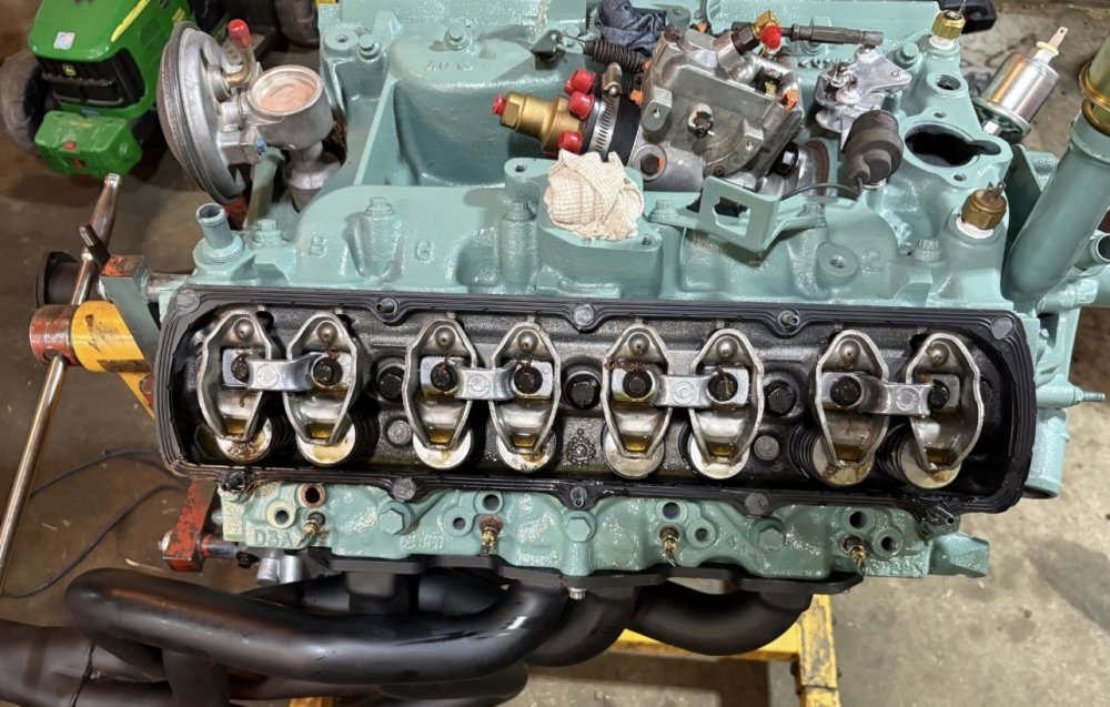

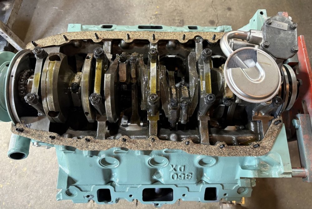

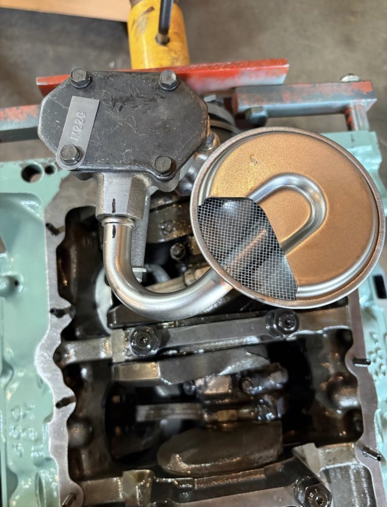

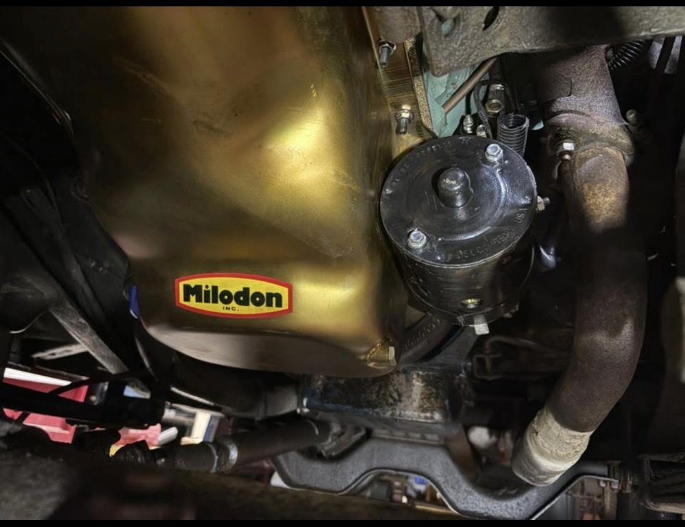

Here are some additional details.A milodon stock capacity oil pan closed up the lower end with a trw standard volume oil pump.The crank is a .010/.010 with a new sealed power camshaft and nos ford 7.3 powerstroke lifters from 1994.They use the same lifters as the 6.2/6.5 diesels as well.Arp main studs,arp rod and head bolts were used also.New wolverine brand rockers and bridges are in place.

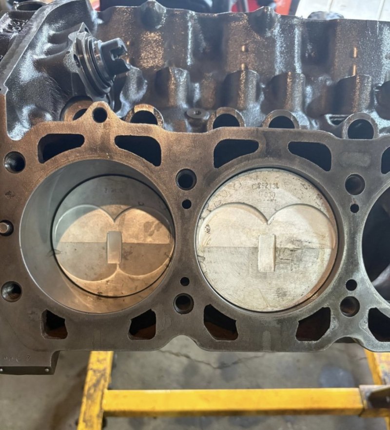

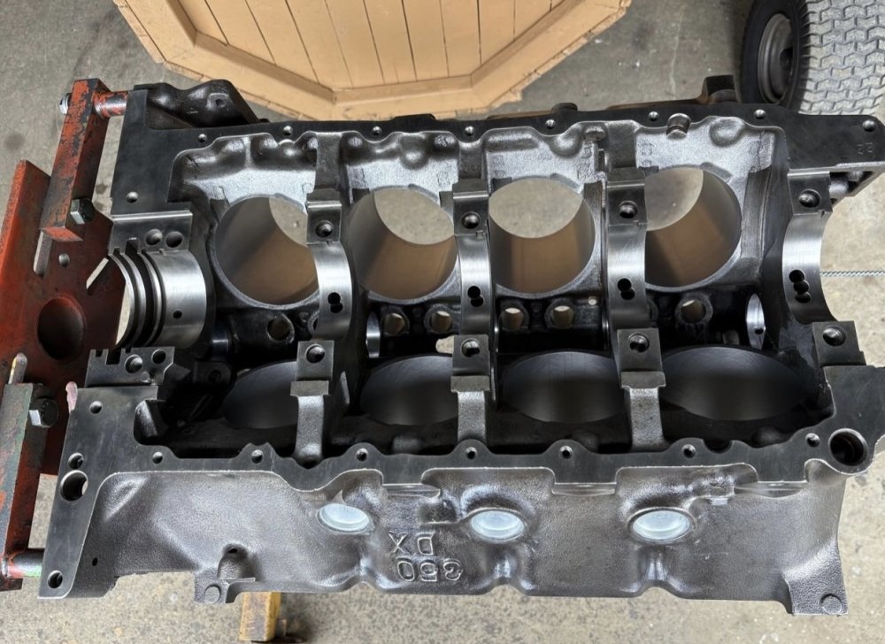

The machine shop bored it .030 over with zollner pistons,sealed power rings.Clevite rod bushings,All new valves and replaceable hardened valve seats.New valve guides were inserted also.A cloyes timing set finished things off with a gates standard rotation water pump.

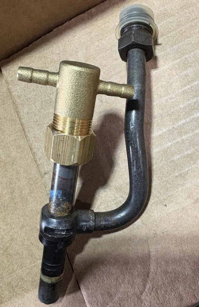

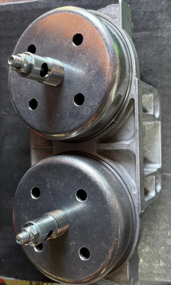

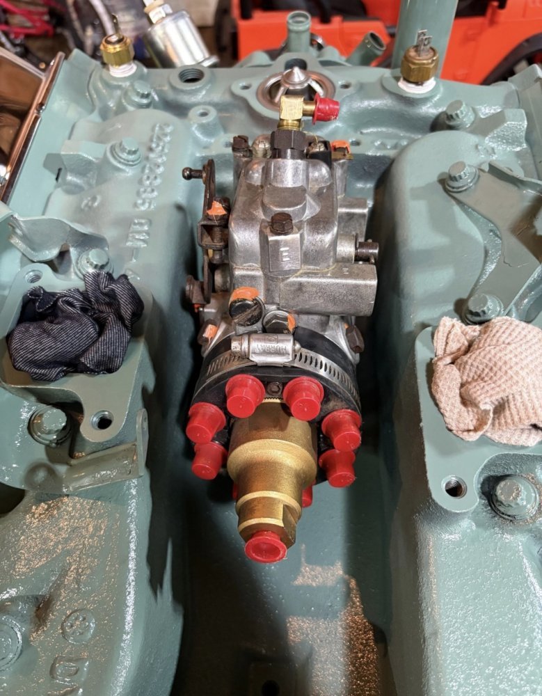

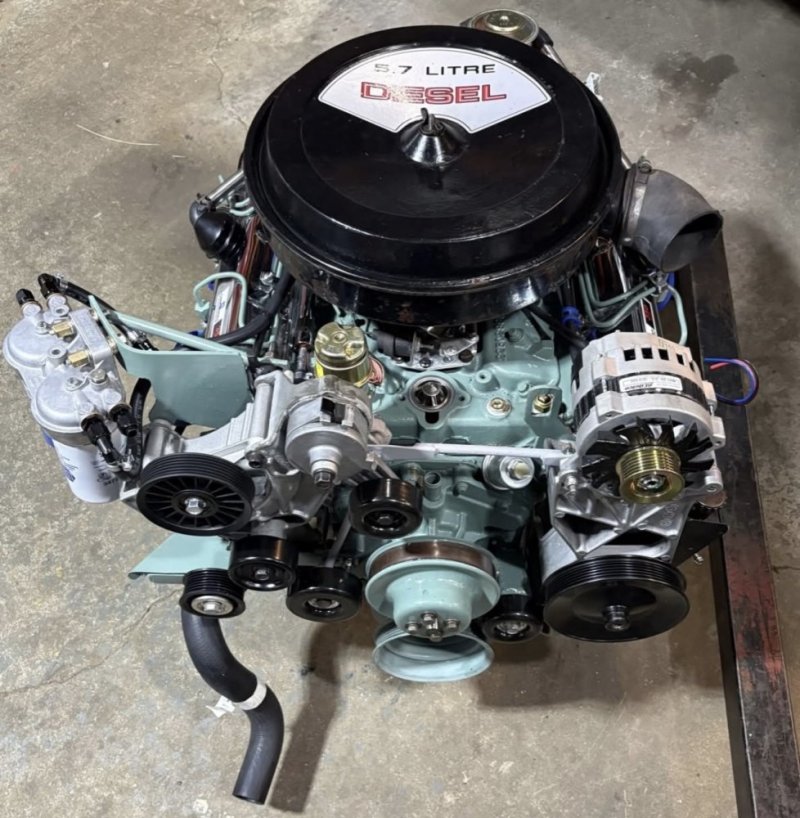

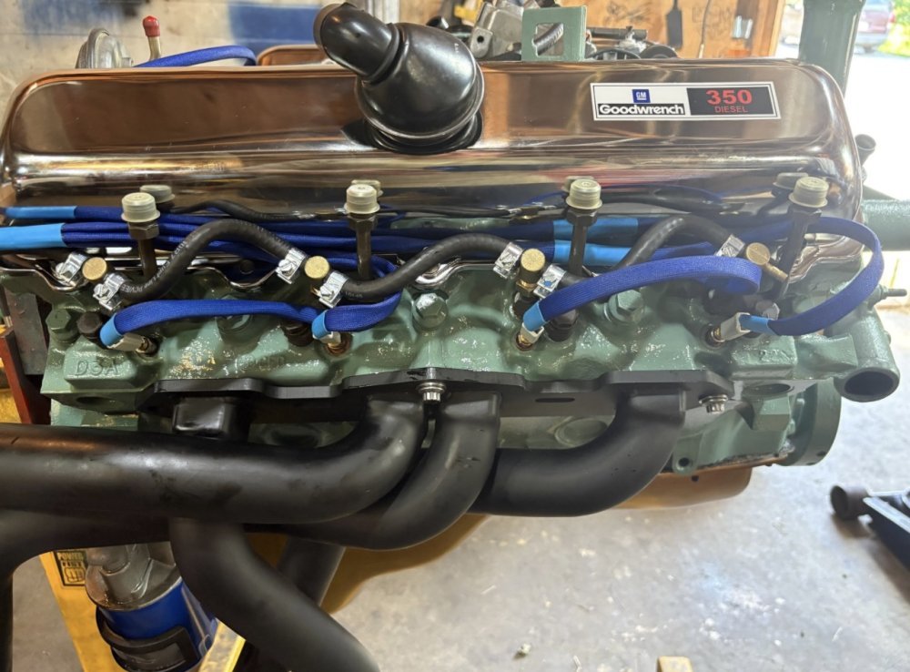

The injection pump is a reman 3916 with all new pencil injectors.Bosch 80034 glow plugs were used with some brass T fittings I found on eBay for a Deere diesel tractor application.A new genuine gm vacuum pump was found on eBay along with a reman gear reduction starter.

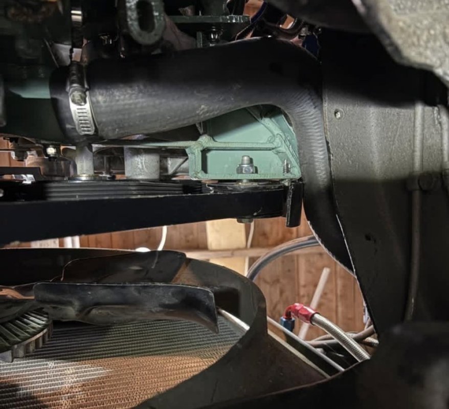

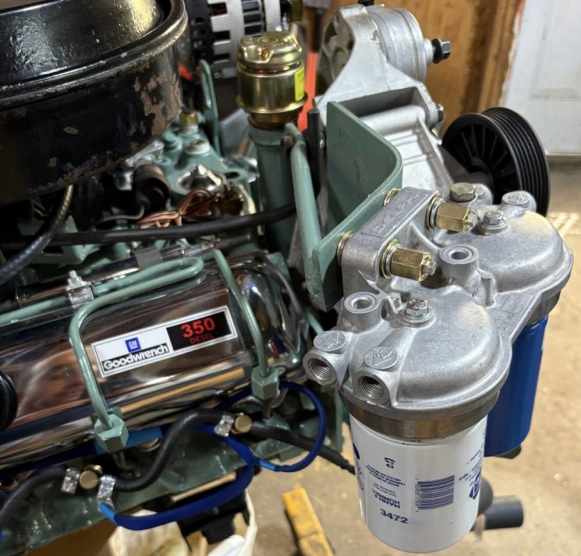

The water pump pulley is from a Chevy 350 but the lower crank pulley is from a late 80s/early 90s 302 mustang engine.The fuel filters are a acdelco tp1069 which is the primary 14 micron and the secondary is a Napa 3472 and is a 4 or 5 micron going from memory.The filter housing is a genuine cav/delphi unit I bought from eBay I would say about 20yrs ago.It has the conversion adapters so I could use spin on fuel filters.I’ll try to find a few pictures so you guys can see it a little better.

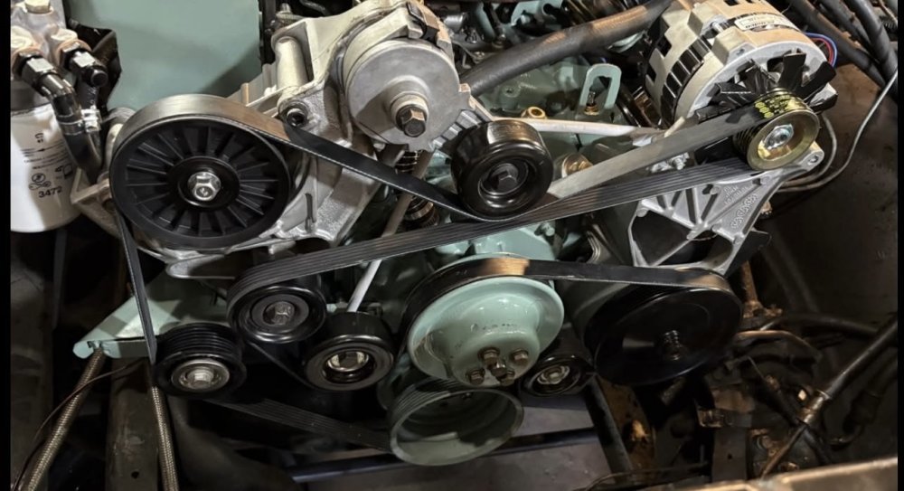

The reason for the excess idler pulleys is because I wanted to keep using the standard rotation water pump since it has a much larger impeller vs the 4.3 diesel reverse rotation version.If I used the 4.3 water pump there would be much less idler pulleys present.I also wanted to get as much belt to pulley contact as I could to prevent slippage under load in regard to the water pump pulley and crank pulley.

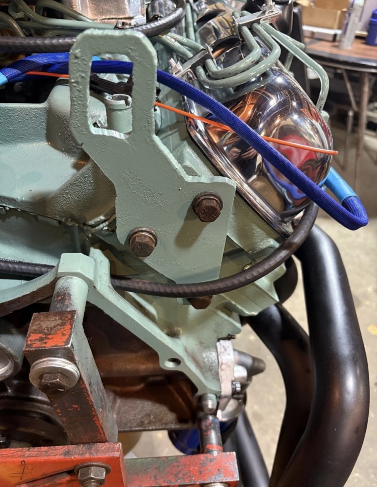

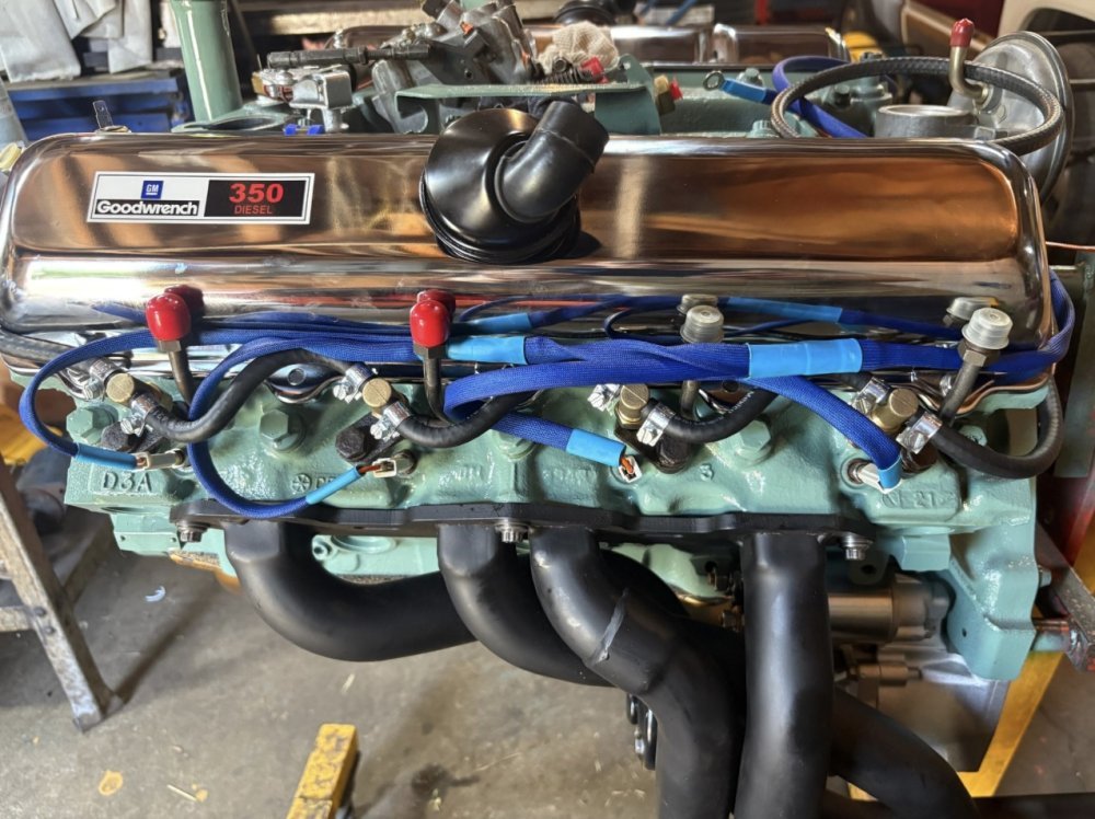

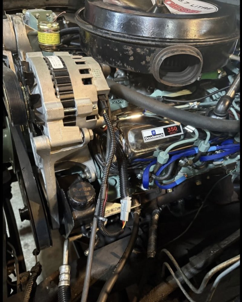

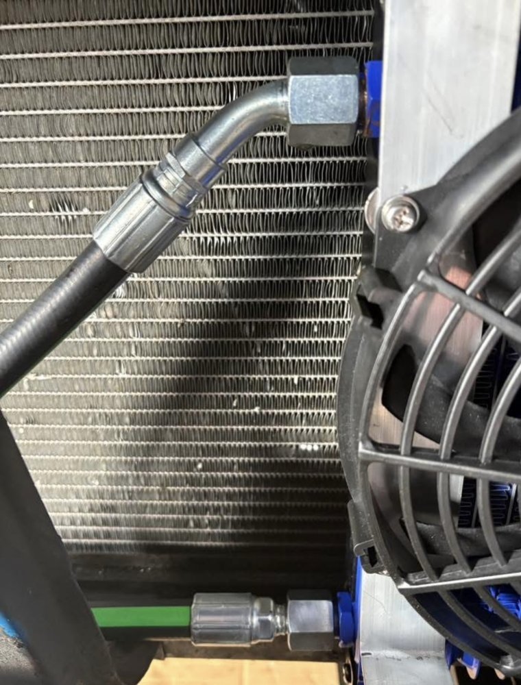

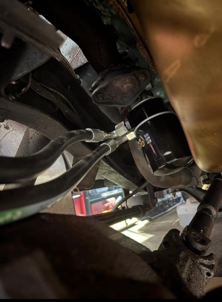

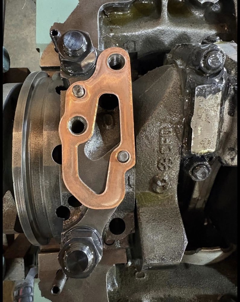

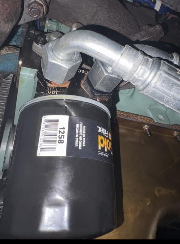

Here are pictures showing the moroso oil filter adapter so I could use the oil cooler.The electric fan is also wired up now with a thermal switch upon the oil line.

I would suggest putting in a FASS water separation filter as well. And be liberal with the fuel lube additive, that IP was more susceptible to damage that the later DB pump

Thanks will.This engine is the DX block.It came out of a Cadillac Fleetwood.I think the filtration is pretty good like you said.The milodon oil pan also has a magnetic drain plug in it too.

I also used a milodon oil pump driveshaft as the stock shafts were known to round out.Milodon is pretty much the best in the business when it comes down to oil pump driveshafts and oil pans.I like the products they offer for Oldsmobile engines.

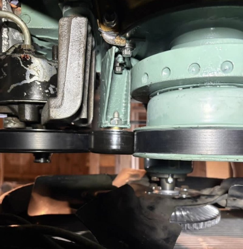

I’m heading to a local machine shop tomorrow to get an alignment washer made with a built in lip to be sure the 302 mustang crank pulley stays centered within the olds harmonic balancer.The mustang pulley has a larger hole than what the olds pulley had so I dont want the pulley to slip and go off center.
