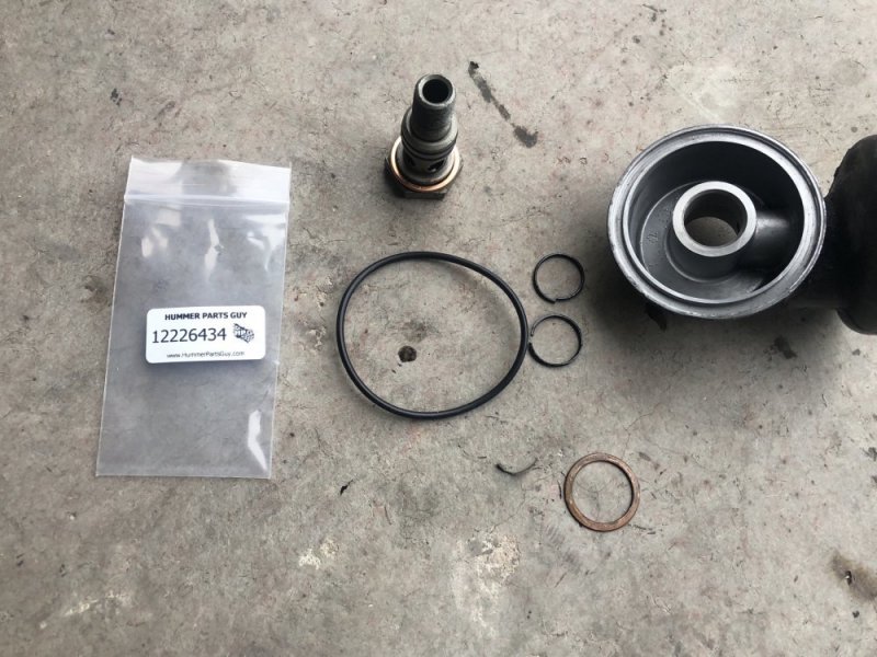

Ok, anyone with a 4wd knows these leak. You loosen the filter and the adapter turns a hair. You tighten the bolt and the oring still leaks. Buy the kit for a few bucks- it’s cheap enough. But doing it every 10,000 miles is annoying!!!
Please someone tell me they have already figured out a mod to end this waste of time. Feel free to name it after yourself so the whole 6.5 world knows you are a hero.
Also someone tell us the engineer’s address that didn’t make a locating pin, second bolt, tab& slot to stop this in the beginning so we can send him oily Christmas cards every year. Haha.
PS. No, I have never tried just The Right Stuff instead of oring... that was my first thought but seems like it will fail also because nothing to stop the rotation.
Will such a easy fix and yet if it’s not done, it’s anoying as hell.

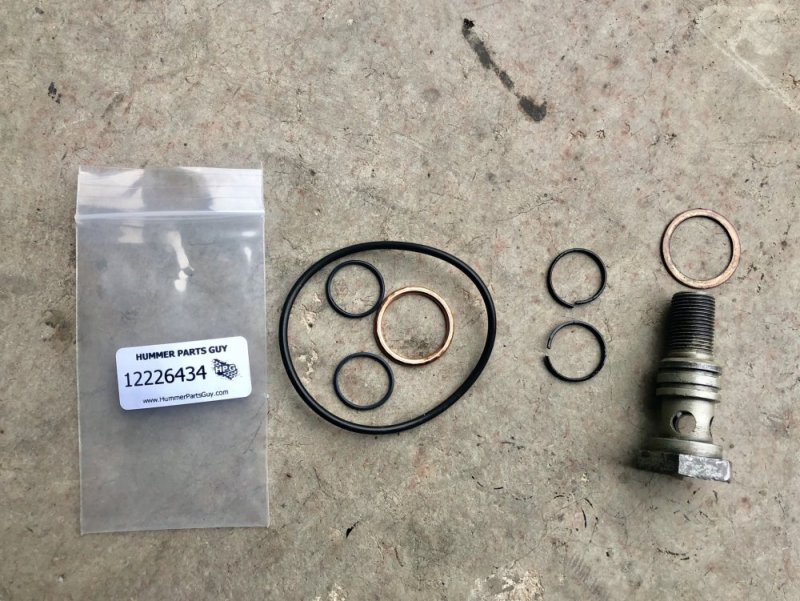

Mine leaks too. I have a Leroy reseal kit ready to go at next oil change, but something to prevent it leaking again would be amazeballs.
Yeah, I am just tired of doing it. I would love to install my engine this time and never touch the orings again.

I suspect it's the aluminum part on cast iron always moving differently with heat cycles. IMO The rotation is just a symptom of failed orings. (Mine leaked just fine without moving. What torque?! The bolt won't turn anymore. )
Then there is extreme oil temps that go past what the rubber o-rings and notably stiff old oil cooler hoses are rated for.
I recall the 1993 is a different center bolt design than 1995.
I think is combination of both, heat destroys the O rings and vibration makes it perfect situation for hot thin oil to seep through,
40lb of torque on the bolt.
