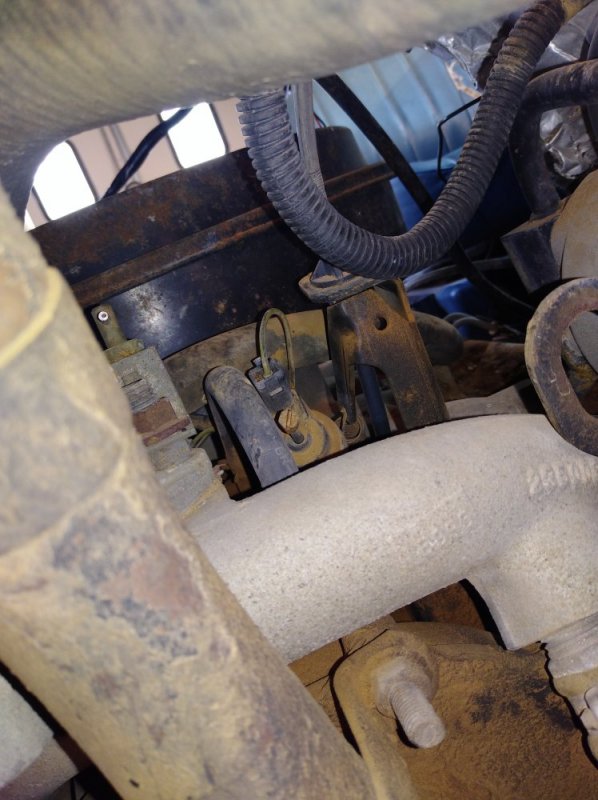

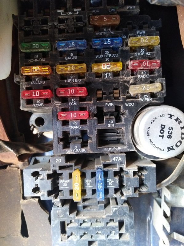

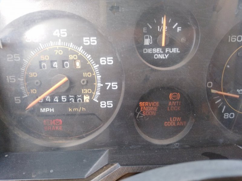

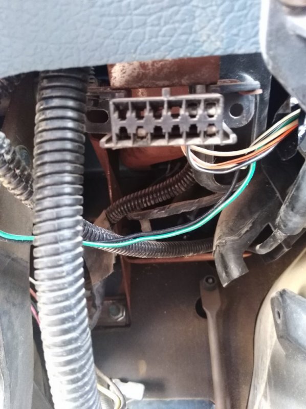

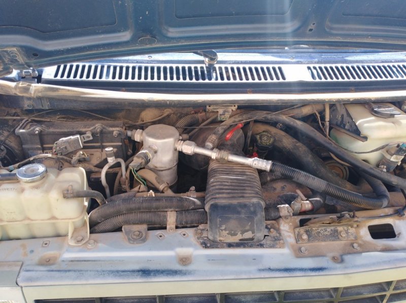

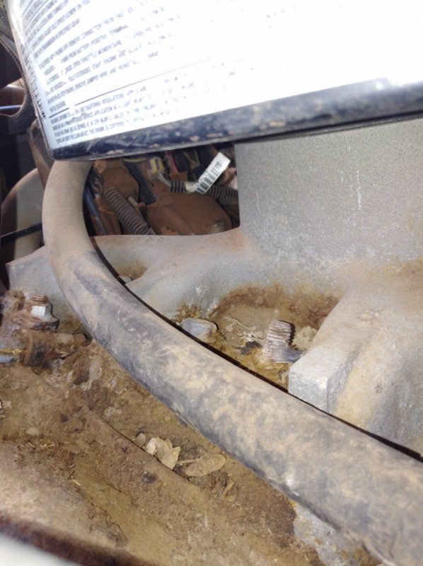

Door for HVAC I don't understand what that is? And as far as I know and can see there is no egr or epr on the van. I does have a CDR valve on the passenger side intake manifold

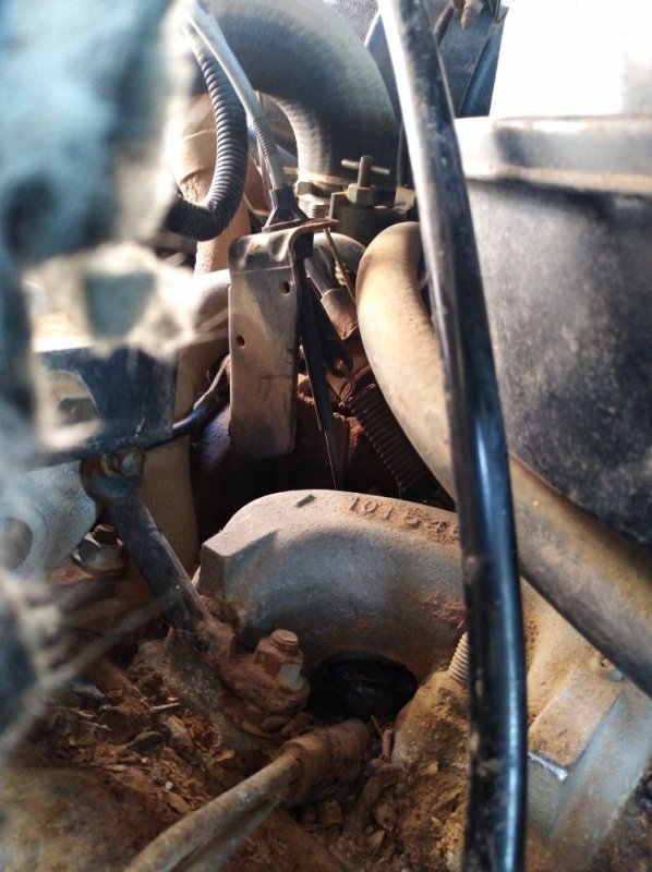

Maybe a pic of the AC heater control head? This is where you turn up the fan for the cab heater or hot/cold. I doubt it uses it though.

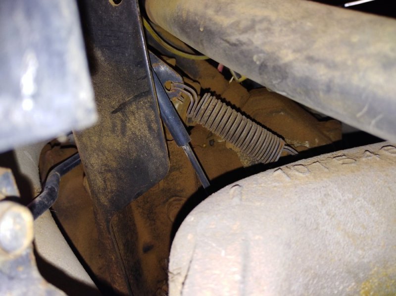

What the cruise control unit look like? Follow the other throttle cable off the IP pump. It's a black box or a round can? Pic?

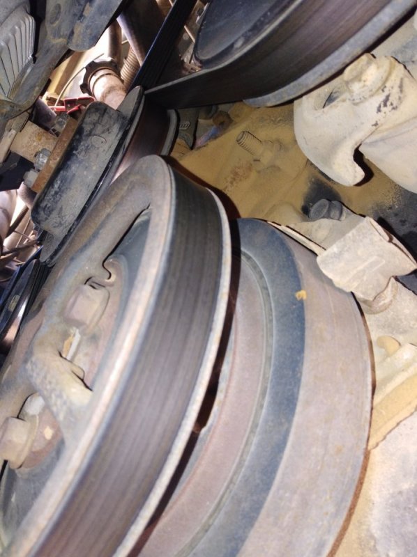

At this point I can't see why you even have a vac pump on the engine at all. Later you should remove it as they like to lock up and burn the belt off. If you are not using it...
Still air force blue haha I'll get y'all a pic of the dash and cruise control(if it has it) tomorrow I was told the vacuum pump is to actuate the AC which on this model was controlled via vacuum signal.

G vans still used vacuum hvac controls. You can always ditch the engine driven pump and use an electric vacuum pump like FORD & DODGE did later on.

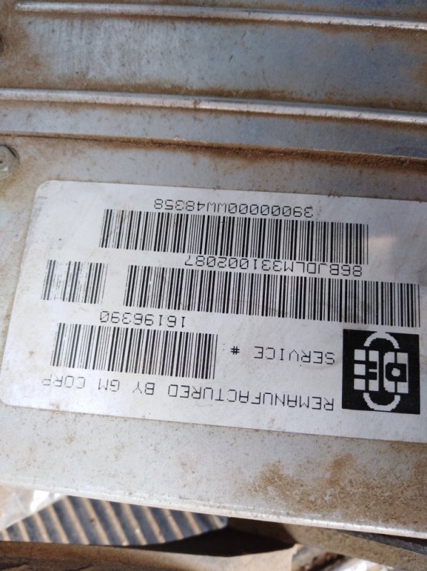

Interesting I'll look it on the electric vacuum pump to control the HVAC.. and the mega squirt I seen them on the diy tuners website but I can't say I'm familiar with how they work... So you have to build it and send it back for them to test out before you can put it on a rig? I'm going to poke around a few scrap yards today and see if I can't find a Y Vin tcm laying around. Thanks again for hanging with me on this THEFERMANATOR.
