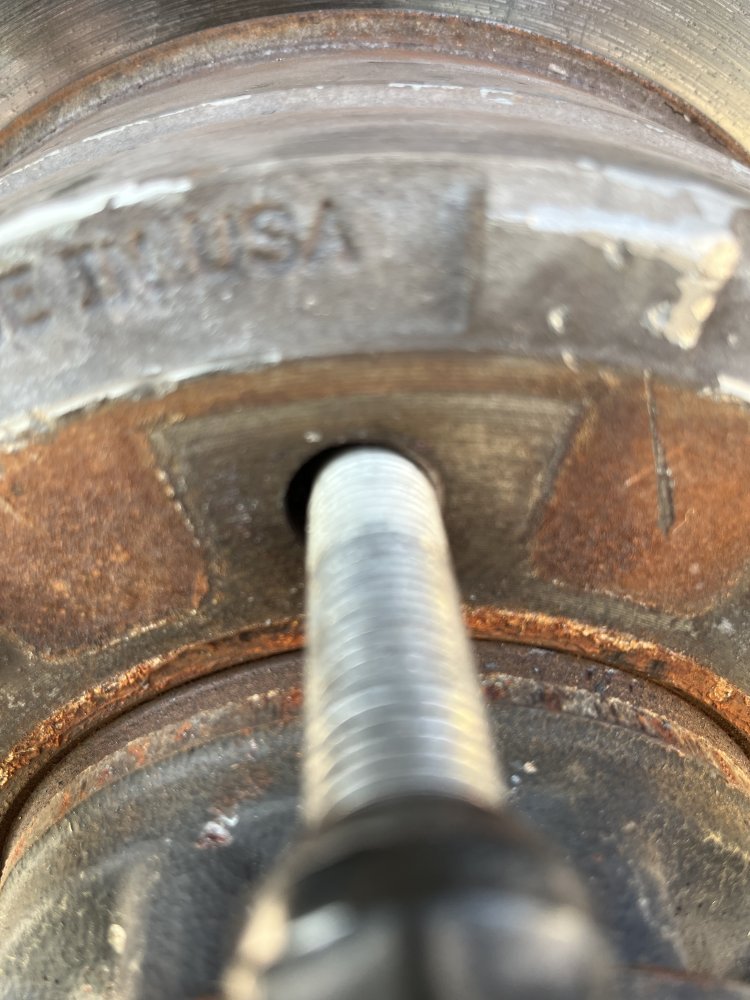

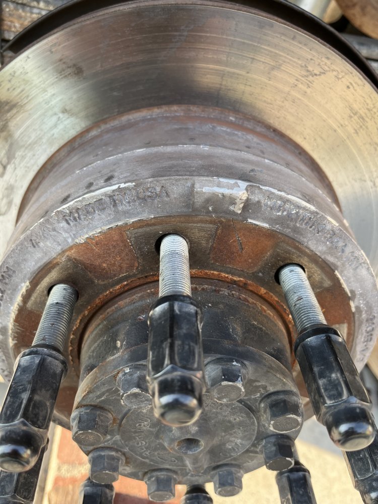

Rotors are stuck on the axle. Note the wheel studs are rammed forward in the rotor holes:
71116342722__CFDD1D99-3878-46EB-B449-4C618B9A269A.jpeg71116343660__4E94A053-0BE1-44C3-82B7-E0455042BAD7.jpeg
It’s my son’s truck. I told him to reinstall the calipers and have someone stand on the brakes to hold the rotor, while using a long breaker bar (floor Jack handle) between the studs to work the axle backwards against the rotor.
Thoughts?71116342722__CFDD1D99-3878-46EB-B449-4C618B9A269A.jpeg71116343660__4E94A053-0BE1-44C3-82B7-E0455042BAD7.jpeg
is this the rear? have parking brake shoes inside? use a torch to heat up the area over the shoes and then a big hammer! don't get it cherry red though. if it's just rusted to the wheel hub. heating in between the studs and use some BP blaster to squirt in the crevice through the stud holes. then hammer on the sides and in between the studs. that usually will do the trick.
Rear. Wondering if he left the parking brake on?
I use about a three pound hammer and rapppp around on the outer edge of rotor. Sometimes around the very outward facing corner of the outward edge.
That usually knocks them to moving and can then slide them off.
Make sure the park brake is released, on the stomper pedal and also the adjuster, if there is one.
My son bashed it off with a BFH. He was replacing the rotors anyway, as they had developed a horrible squeak when warm and they had 100K miles on them. Installed PowerStop Pads and Rotors (drilled/slotted) as that was what the Ford Forum posters recommended. I was in the truck during break-in of the pads and it was fine.
