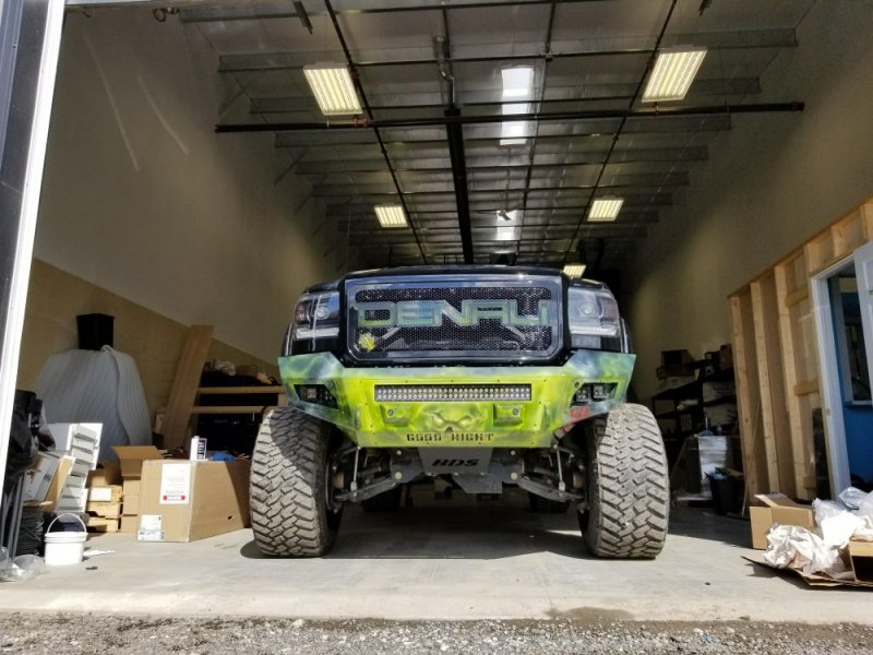

Sorry Man it's going good.
I was able to find some files for isuzu that worked on the lml. Tuning is going great. Doing the motor in this beast next week
