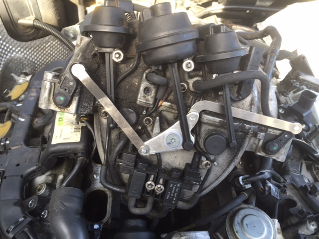

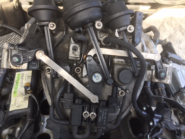

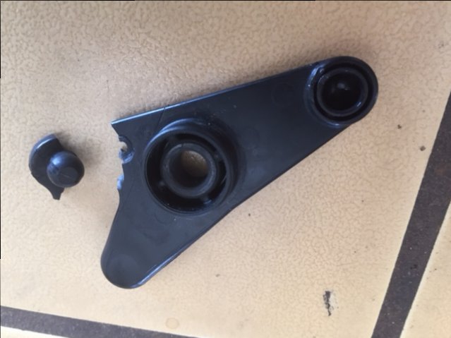

I got the same issues installing the repaired manifold (see pics) as with the new manifold. I only touched a few things and I've checked them all. I think it's down to redoing the gaskets, as they easily shifted around when dropping in the manifold. That or the intake snorkel below the MAF may be leaking or cracked. I removed that by twisting it slightly, then pulling it off. It's plastic and all the plastic crap on this engine is brittle at 100K miles.
