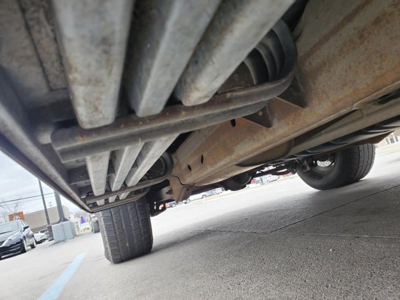

Test drove it and it felt a little squishy - but from the pictures it looks like it could use anti-sway bar links. Not going to worry about a whole lot for now - at least until I get the car sold and a privacy fence built.
