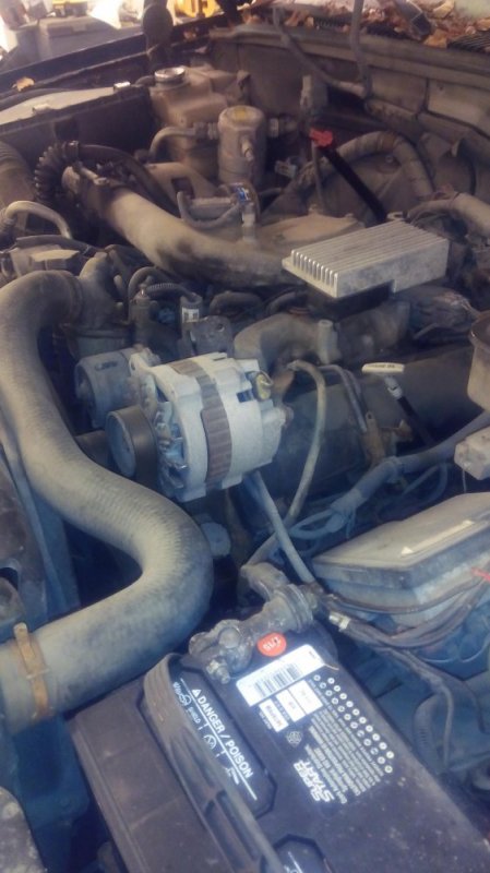

Pic of the engine in the truck still. My first priority is to get all the plow stuff off and if I have time pull the engine.
