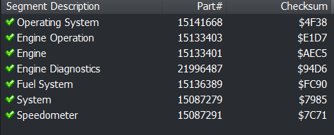

Thank you very much for the bin file, so im new to this and im just wondering i went to read my pcm and it appears to be locked unable to read the seed bty im using pcm hammer any help would be greatly appreciated
It's definitely possible you have a locked ECM. Efilive gives tuners the option to block reading when you build a tune.
I'm not familiar with PCM Hammer, but Efilive will give you the ECM information, as you can see in my screenshot,
even if you aren't able to read the file.

If you can find out what your ECM segment numbers are and post them, we can make sure you get a matching file.
Unfortunately, that's not enough information for me to guarantee that the file I posted is a perfect match. You have a few options at this point.
If you know someone with an Efilive tool, maybe you could borrow it and get the information.
You could buy a file that's a guaranteed match from a site like this: https://mscservices.net/collections/gm-stock-tis/products/duramax-2001-2016-ecm-stock-tis-files
Or, you can try flashing the file I posted, and just hope it's right. 😟
