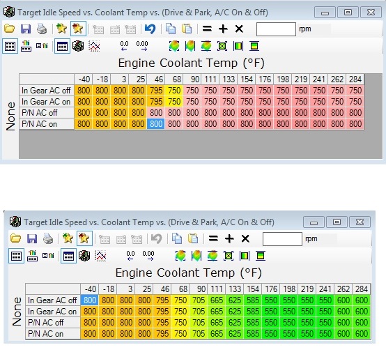

So we fix GM's engineering and bean counter compromise likely due to CAFE. 550 RPM ARE YOU FING KIDDING ME?! Enter HPTuners:
May fine tune this some if the RPM drop between gears or P/N drops the clutch from triggering the anti stall code.
Didn't like 750 RPM in gear as it would vibrate with a harmonic. So set it to 700 RPM. Shifting into gear does kick the AC clutch out with the "stall saver" seeing a 200+ RPM drop on the 1st shift. Shifting again doesn't trigger it or drop as much RPM.
106 degrees F out and COLD air at idle... Finally!!! Long hot summer with lots of over 100 degree days out here.
