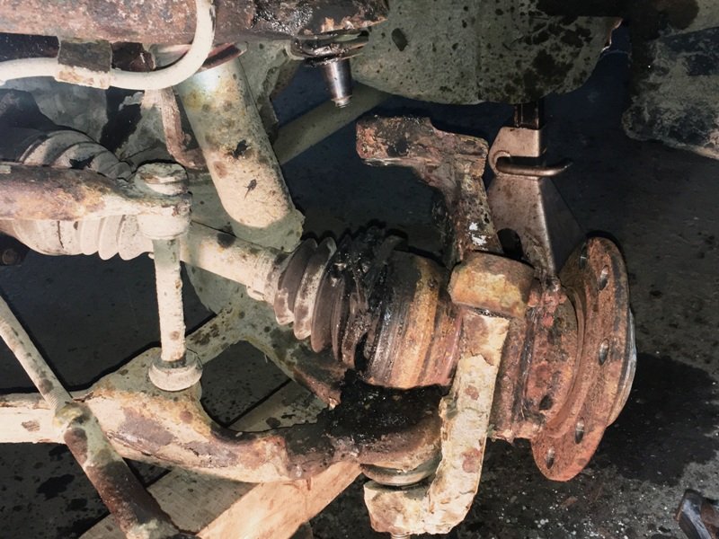

So it started with a squeal, truck wasn't hardly driven before wheel bearing let go and became a catastrophe. Truck only has 72k on it, must have been affected by all this gold old NY road salt!

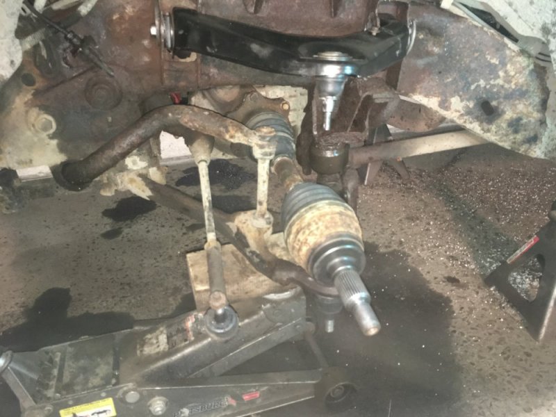

Got all the main parts from auto salvage, axle shaft, steering knuckle with bearing, rotor and caliper for $200 bucks.
Got a new upper arm with ball joint, new ball joint for the lower arm, new brake hose, got it all back together.

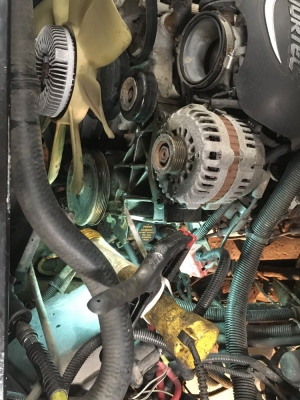

Started pulling pump Friday after first round of clearing driveway. Foot and a half of wet, heavy spring snow, mixed with mud, yuck! Got steering pump off and then lost power before could get any further. PS Pump_1.02.jpg PS Pump_1.02.jpg

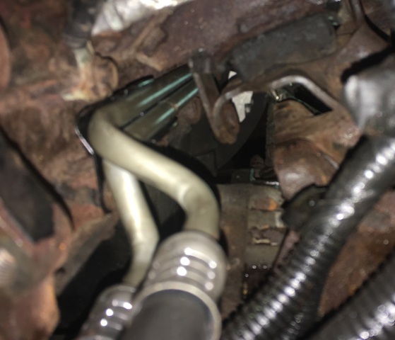

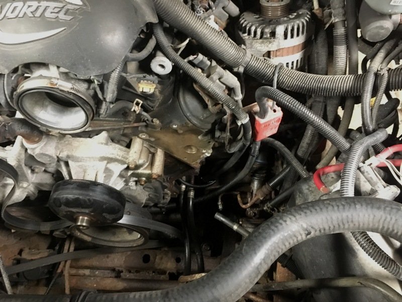

Update: March- in like a lion... so they say. anyway, got some new oil cooler lines in while the steering pump and bracket was out. Lines were a tight fit, had to disconnect left side engine mount and raise up with porta-power under the oil pan. Would have been worse if power steering pump and bracket were still on motor.
