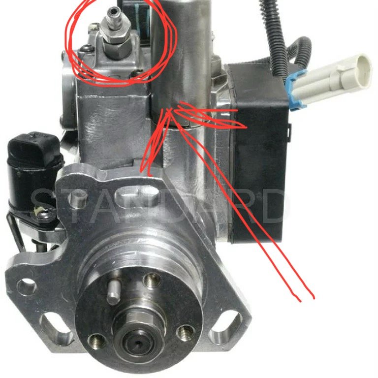

Where exactly and how exactly are you testing fuel pressure? Pictures or YouTube video link is a good thing.
If this is where the return fuel line connects, that you mentioned. I have done so earlier, but forgot to put it in post. It has fuel flowing out.
I assumed fuel pressure is good due to the fact I forgot to put the screw back on the fuel filter cap and fuel went everywhere with a lot of force.
It’s like it has good pressure and fuel comfortably makes it up into the IJ. The IJ allows fuel to come out of the line I mention in the picture, but not to injectors.

Yes the circled port is the return line. Just keep the clear line on there.
Watching for bubbles and contamination. It doesn’t take too many bubbles to make the optic sensor not function.
The other fuel port is the inlet. I suggest getting this adapter, adding a permanent mounted pressure gauge in the dash so you can read while driving. Proper pressure is 8-14 psi. As long as it is over 1psi the engine should run, unless the injection pump wasn’t getting proper pressure and has worn out the head and rotor. The lower pressure wears it out faster. Going under 0 psi into vacuum causes cavitation and wrecks it quickly.
