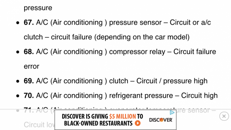

Thanks I've had issues both speed sensor pigtails were bare wires replaced those and speed sensors. replaced ignition switch per low voltage helped for a minute. od works for along time unless I get over 55mph. 99% sure something electrical is the issueView attachment 62118
OBD 1 code 68 has nothing to do with the transmission. AC compressor relay fault. It could be the same circuit might have something to do with controlling the overdrive function.
Usually though, a fault with the overdrive could be related to the coolant temp sensor located near the thermostat housing on the gas powered engines. Most times though, if the ECT sensor is faulty, then the torque convertor lockup will also be disabled.
Count how many times the engine shifts getting above 40 MPH, then, touch the brake pedal, not step on it, just a touch, the engine should gain a couple hundred RPMs when the brake pedal is touched. If You count four shifts, then the OD is probably functioning and the TCC lockup is failed.

I have no slipping just hoes into lock upCode 68 for an obd1 4l80e is for trans component slipping. You need to get a scanner on it and monitor input vs output speed sensor readings to get calculated gear ratios and to find how much slippage you're getting. Code 68 is pretty common when your direct clutches are gone.
Code 68 for multi port fuel injected cars is for the ac, tbi trucks are different. This is part of the reason for obd2 and universal p codes. Oem hex codes could have multiple meanings depending on the platform it was in.View attachment 62118

Code 68 means it detects slippage. Just because you don't notice it does not mean it is not slipping. Since you say it does it in 4th, it may be your converter slipping which is not that uncommon for valve body wear in the tcc valve bore. They sell a tcc lockup valve that has a seal on it for this problem. You need a scanner on it so you can see what it is seeing.I have no slipping just hoes into lock up
