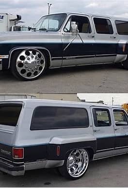

I believe that there was a dually version of the Suburban from the factory but I think it was a rare item.
Possibly better snag the rear fenders from whatever vehicle You pull the duals from. I might be wrong in my memory banks but I think thats what the Suburban I seen had on it.

V2500 is when Chevy went to the new body style and changed the older square body to the RV model . V 2500 is 4WD and 3/4 ton . Tires are the same on my 91 V2500 and my 86 CC dually . I have seen the dually Suburbans but I want to say the dually fenders came onto the rear door so they are not the same as regular dually fenders .
