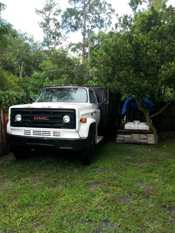

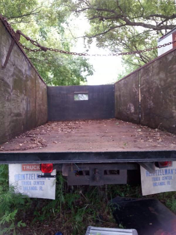

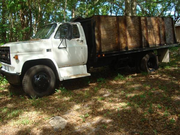

I'm almost there. So far:
Fabricated a complete floor in the cab.
Rebuilt the seat.
Rebuilt the hydraulic controls.
Replaced and rewired all the lights.
Replaced the battery.
Repaired the starter.
Patched a hole in the gas tank.
Removed the primary fuel filter and added an inline filter.
Replaced the hydro booster.
It's probably road worthy at this point
I've still got a few small leaks here and there. One is the PS pump seal and one is in the PT.
I'll be doing a lot of metal work and painting on the body but for now it should hold.
Air vents are full of whatever the rats and squirrels left behind. The smell kills me.
I'll have to go over the motor and the hoses.
The driver window needs a new mount
But for now, it's time to make money.
