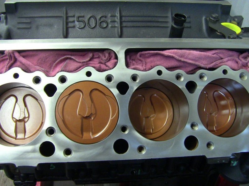

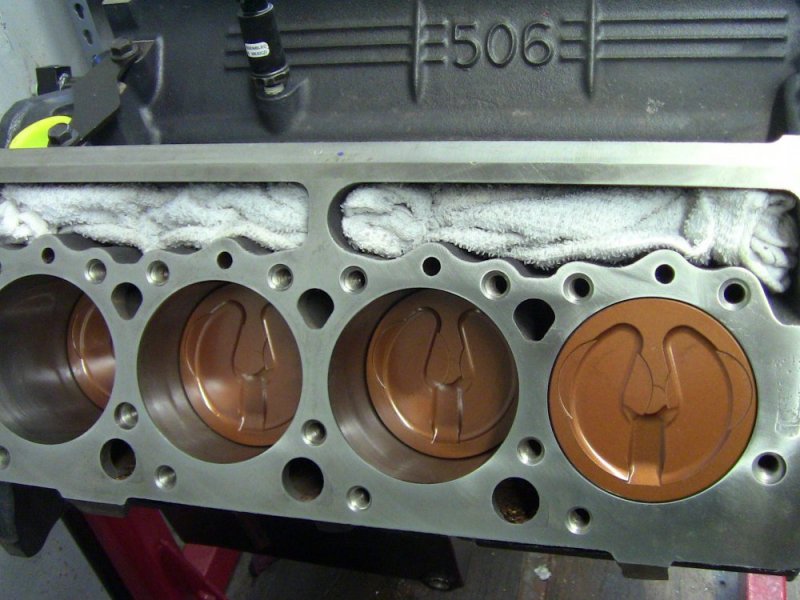

I have made mods to my p motor for 1.7:1's...
I machine these below.... and you will need pushrods and some grinding for clearances ....
I have 1 set left with valve reliefs...

I may have been one of the first years ago with these rockers, they will smooth out and quieten the motor to the extent it doesn't sound like a 6.x.. and as always the valve geometry should be checked, ie pushrod length, and valve springs will provide much better valve control, I also speced springs with PAC racing springs if needed...
