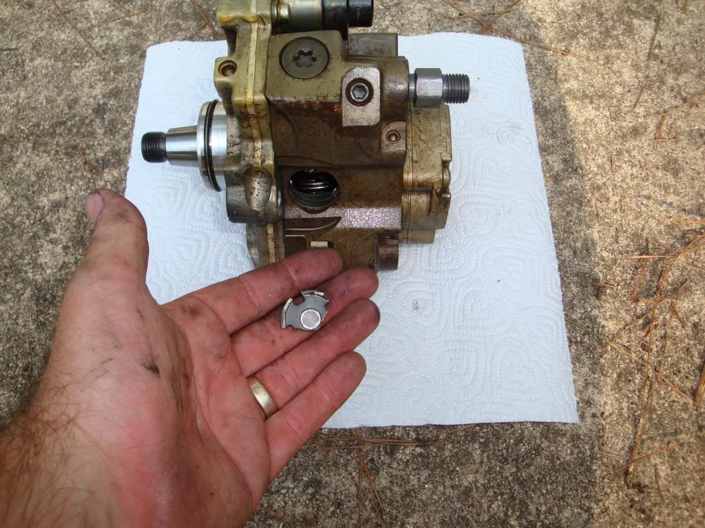

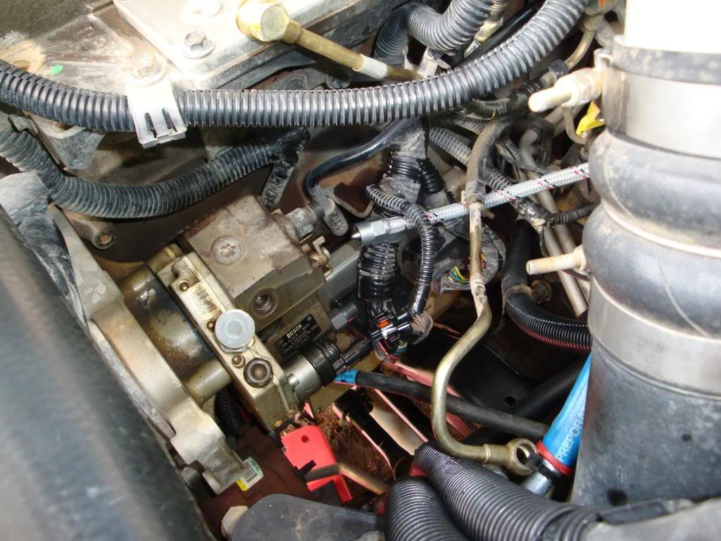

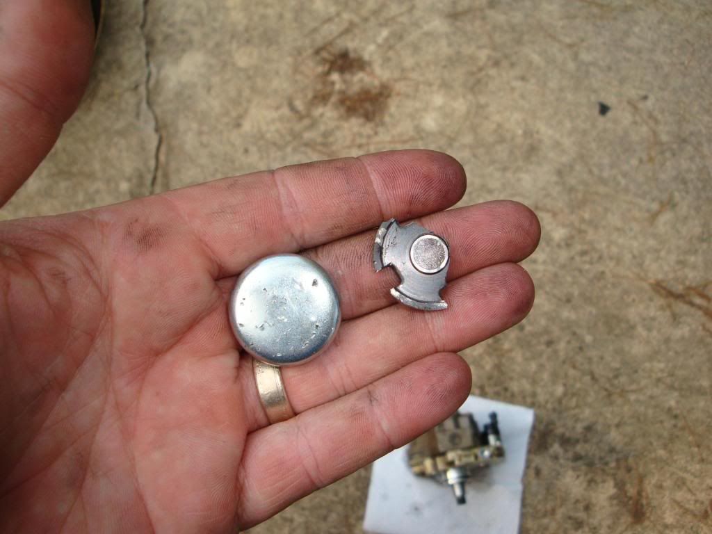

Here's what happens if you don't know what you're doing on that pump. This is a customers truck messed with his pump and didn't understand the implications.

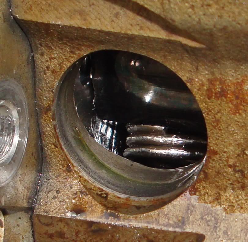

This is what happens when you cap the rail or crank the pressure up too high.
This is a cracked injector body and nozzle.
As I said, rail pressure is the LAST thing you want to add to achieve power on a common rail.
You can see the crank in the fuel bore in the 5 o'clock position in the picture below.
You can see the discoloration in the fuel bore in the 5 o'clock postion which indicates a crack. What you can't see in this picture is the face of this nozzle is actually spider webbed. Much longer and the entire nozzle would have come apart and this would have meant rebuilding the motor and getting a new head.

The injector was too much rail pressure and it cracked the injector.
The pump was what happens when you turn up the low side pressure and it blows out the seal. This blows the plugs and destroys the pump internals.
If you don't have a test bench to calibrate the pump, you DO NOT want to mess with it.

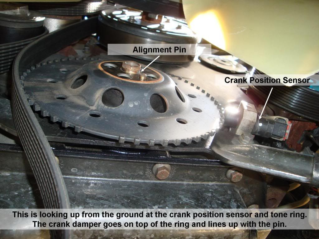

Found a better mod,people are moving the crank sensor or the tone ring to advance the timing about 2 degrees,sounds fairly safe.
It's not that easy to just move the tone ring.
It's bolted and pinned behind the crank damper. You have to drill new holes in it. Moving the crank sensor isn't happening either, unless you do something like a Roktech.
Besides, 2 degrees isn't going to net you squat on a common rail. Electronically, you can add up to 9 degrees of timing.

You can pull the crank sensor off and the truck runs just fine, it just throws a code. The only thing it does is send the signal for the tach and acts as the primary sensor to the ECM for engine speed.
The actual timing is done via the cam sensor, behind the injection pump, which is the primary sensor for timing and is the secondary sensor for engine speed. Unplug that an the truck won't start.
The only thing you did by sanding down the tone ring is tell the computer that the engine is running slower than it is, which can cause it to bump the actual engine speed up to put the idle within the correct parameters. Opening the gap in the tone ring simply increases the amount of time that the sensor goes from 0 to 5 volts, which tell the ECM the engines speed.
