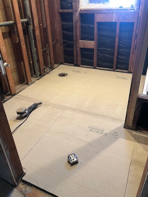

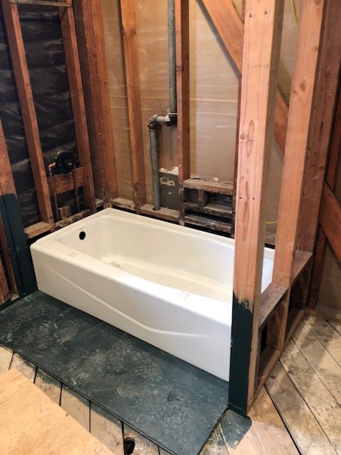

I have a fuel pressure gauge, but it's a temporary Harbor Freight model. Intalling a "T" in the fuel line between FFM and IP sounds like a permanent install. I would like to do testing on this in the AM on the 4th. Otherwise, I've been busy with a bathroom remodel project for my sister.
