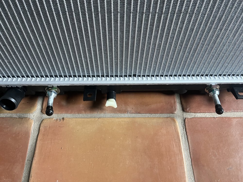

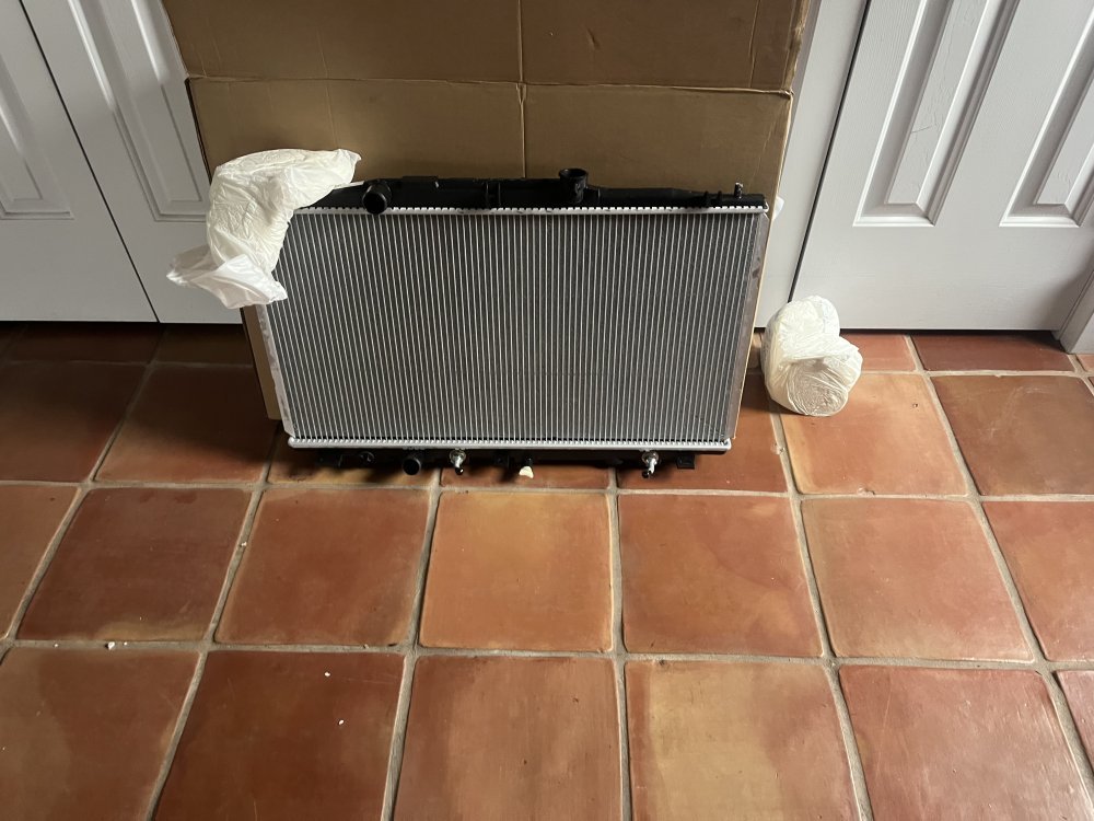

IMG_6175.jpegIMG_6176.jpegRadiator on my ‘05 Honda Accord EX 2.4L w/ 5 spd manual developed a leak in the lower plastic tank. I ordered one Denso unit from PartsGeek whose site stated it fit vehicles with manual transmissions. It came with the cooler fittings for an automatic transmission. Sent the unit back and they sent another which also came with the same fittings (capped pipes).
In the course of doing my research I talked with one manufacturer here in Georgia. They gave me model # and said to simply plug the cooler line fittings. The pics show the second unit and it has the same fittings. Sounds like I will have to plug the transmission cooler fittings. I was hoping to avoid this as one would think the transmission cooler would create a dead spot in the radiator?
For the record, existing radiator does not had the transmission cooler fittings. Also, 2% of the Honda Accords sold in ‘05 had Manual transmissions.
You won’t loose anything from them. Thats just a tube running through the tank submerged in the coolant. Those don’t run into dedicated fins or anything.
The caps you have on are fine- just remove and put some silicone on then slide them back on. Better would be a larger cap you can put a hose clamp on. The only reason not to let them remain open is water could go in that tube, rust from the inside out, and create a leak through that path. You could always tell them to send you caps and stainless steel hose clamps for it or send it back and buy a different brand.
There is the really slim chance that the fittings could leak where they penetrate the tank wall. It has happened but is so rare you are more likely to find a bag of money on the ground.
Then last possible issue: if there is some component in the way in the car from installing it.
