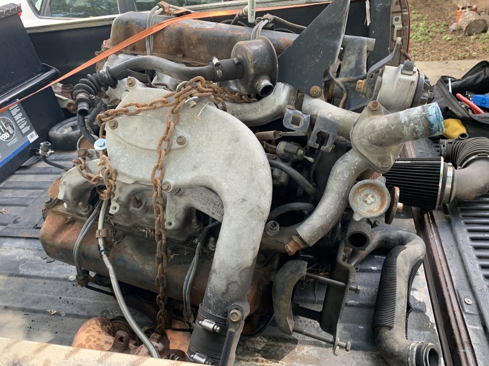

Now to dig into the details of the newly acquired engine. at first glance I had thought it was a 6.5L since it had came from a 94 truck, also noted that it has the DB2 IP and a factory GM-3 turbo. I cleaned up the areas on the block so I could see the casting numbers and learn some details on the engine.
Block casting number is 14022660 and stamped on the front of the block reads GM 6.2L.
so learning that this is a 6.2L with a turbo tells me this wasn't the factory engine in the truck they pulled it from. There are some other casting numbers and symbols that I took pics of hoping to try and identify what year the block is and learn more details about it. Hoping this is a good one to work with.

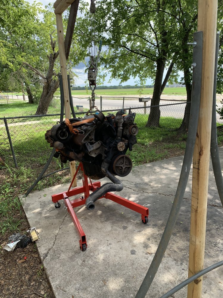

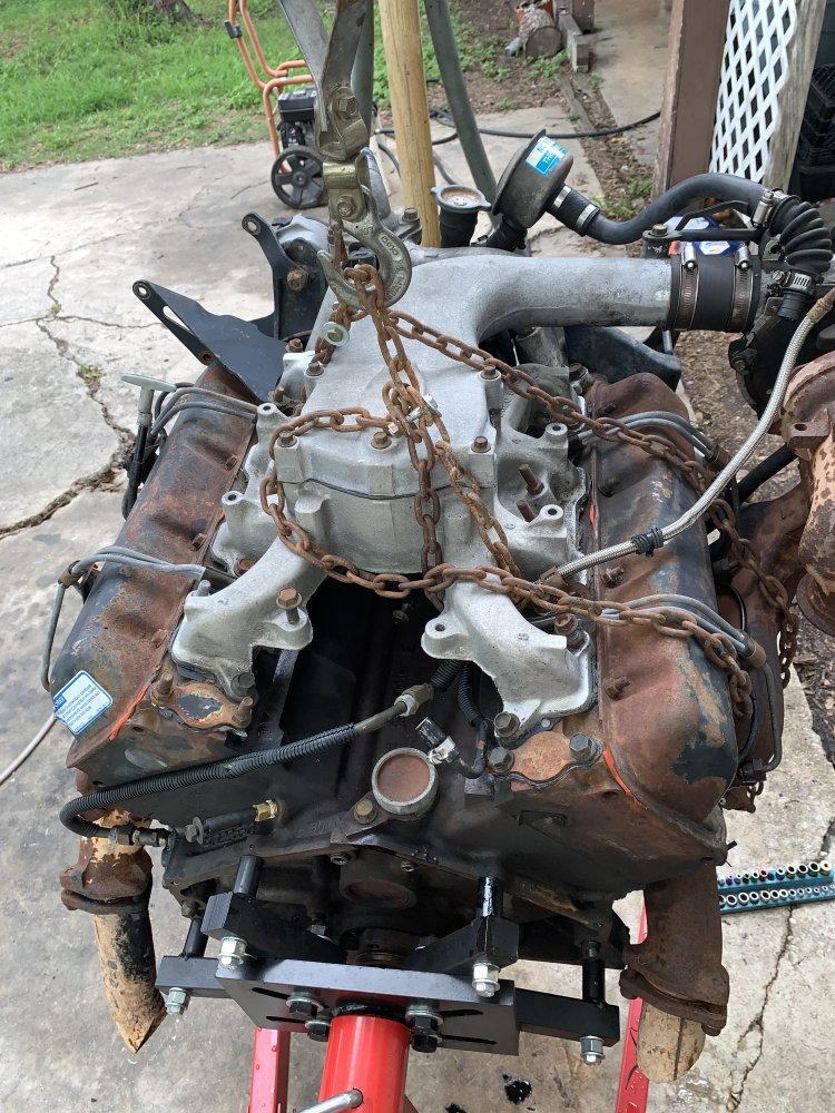

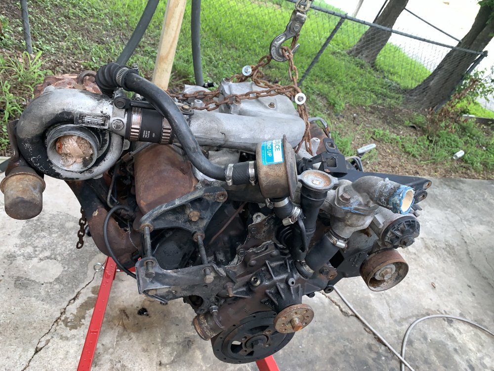

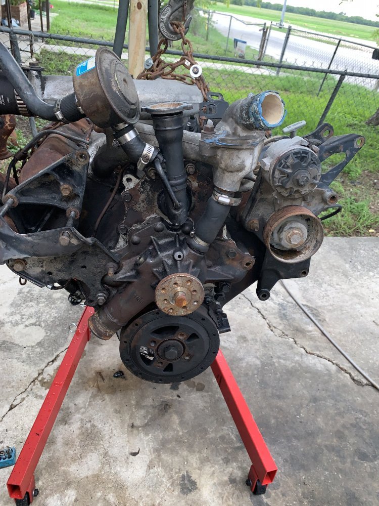

below are some pics of the engine as it was when I got it and after using the power washer on it cleaning it up some on the stand.
Ok, here are some more pics. I found while inspecting the engine that the crank pulley was shot but the HB was still in tact. it had beat up all 4 bolt heads to the point a socket would not go on them to remove. I thought about it a minuet and remembered I had in my toolbox never used fancy socket that was made for this sorta situation. lol it paid for it's self here!!

I have a curiosity on the GM3 turbo that came installed on this 6.2 I got. it has an actuator on it that does not have a vacuum port. I did try moving the actuator with a pair of pliers and could not get it to budge. not sure if it's just rusted shut, but I assume there is a heavy spring in the actuator similar to how the turbo master works so it doesn't need a vacuum pump to operate.
are these pre-set to a given PSI for the boost? if so does anyone know what it's set at? and is this a better actuator setup than what the newer turbos have?
