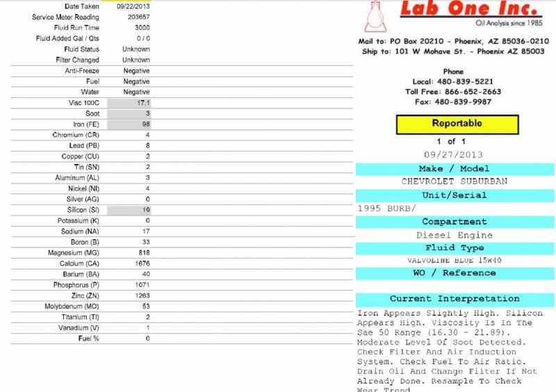

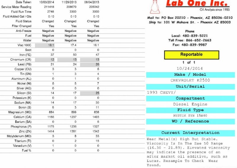

I Run the higher 50 weight out of the gate as it is so hot here I can loose oil pressure at a hot idle. Gapless rings look like this on 15w50 Mystik. Note Soot = 0 and the smoking dirty 1995 non-gapless burb engine was higher:
Here is the limits of conventional oil on the 1995 regular ring engine, hot summer with a spool valve ATT setup. Synthetic oil was used after the next change as heat was ruining the oil. This is 15w40 oil and normally in the 14 range!
