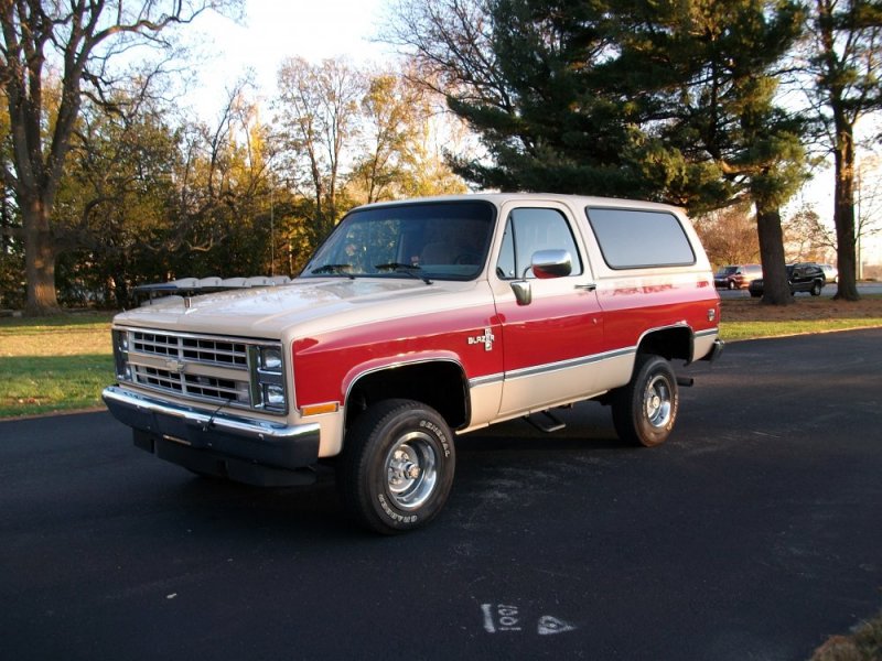

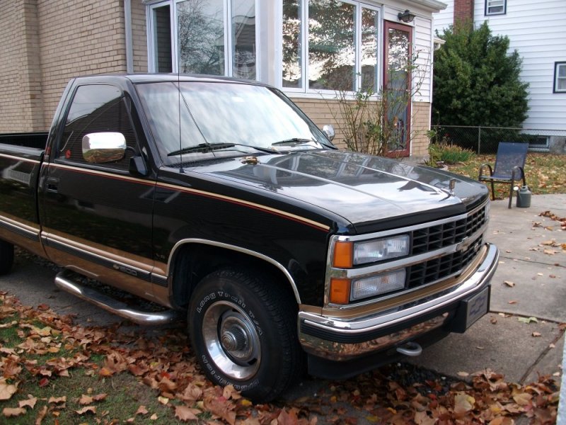

    I never heard that Fram was making Mobil-1 filters, but I'm not sure about much these days of cutting cost. Personally I use AC Delco PF1218CL and Mobil 10/30 in the 88 K5 Blazer and Mobile 5W/30 in my 90 Silverado fleet side pickup. I'm not too sure, but I've never had any trouble using Mobil products. As far as for Fram, I'd go on using a dirty filter over installing any Fram product. I'm 64 and back in the sixties they made a good products, but once in the eighties the bean counters took over and the product/s quality went all to hell. I don't know how they stay in business. But the average motorist hasn't a clue what the quality of a product is. If I got a doubt about Mobil products, I'd go with Royal Purple in oil and filters.
    Here's the two I've restored over the last 6 years.
    This country is run like a blind man's ice water stand.
    Will L. and WarWagon like this.

    Hey Killian, welcome to TTS.
    x2 nice looking trucks.
