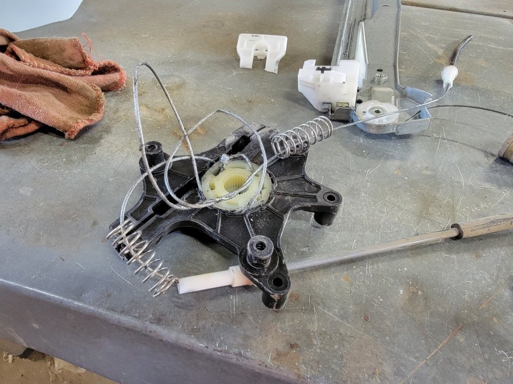

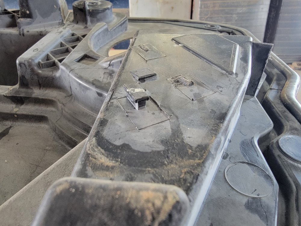

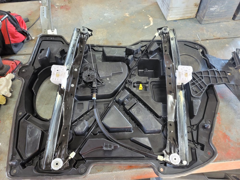

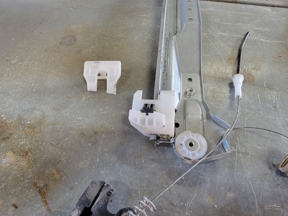

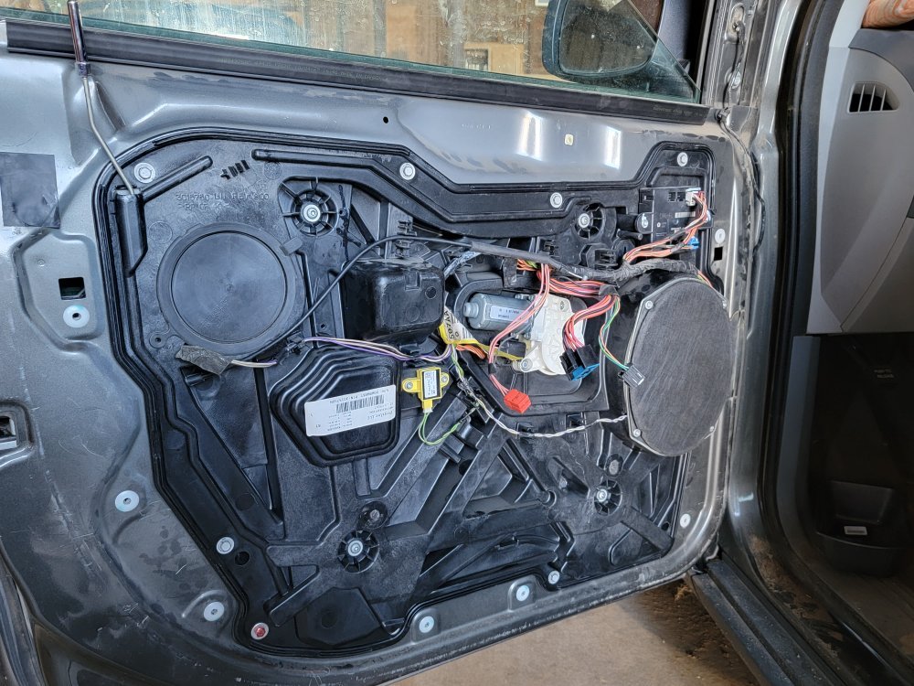

This is, what I call the Queens Chariot. I think I work on this more than all my trucks combined. About a month ago, my wife told me she went out to go somewhere, and the driver's window was down, and would roll back up. So I took the door apart and found the cable window regulator had broke, or exploded more like. Someone been into this before me and broke tabs off the carrier (inner door panel). Parts were special order. Took a month to get them in. Left the truck in my shop so it wouldn't rain into the interior. Got the parts in today and put it back together. Went together so easy, I thought something was put in wrong. But all works very well. Still worries me. Like putting Legos together. You drop it and you have to find all the pieces, and put it back together.
