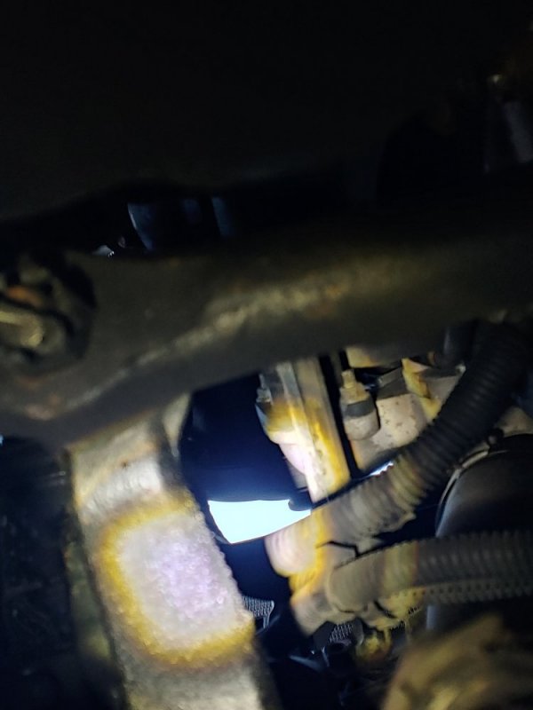

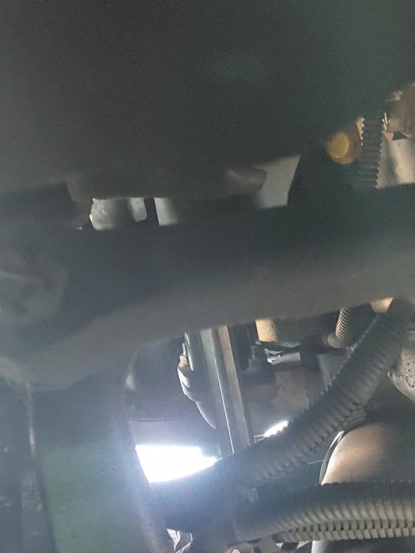

So far I have removed the pipe coming down from my intake so that I could get to a bolt on the passenger side bottom of the circular fan shroud and I have broke free the 1 7/8 in nut for the cooling fan. Before I go farther I think I need to see that I can get these bolts off the back side of the water pump. How to access them?

The pics are from laying on the ground looking straight up and the nuts are in the middle of the picture. This is the back side of the water pump. There is a brass colored piece of metal that is horizontal and longitudinal running directly between the two of them in the picture.

Those nuts are not fun to get off. I usually use a swivel end ratcheting wrench to get them loose. Its tight and tedious.
The balancer needs removed to get to the one WP bolt. You need a 36mm 12pt socket and the BIGGEST breaker bar you got. There's tools to hold the engine from turning. But you can do the same thing with a properly placed pry bar.
Thanks for the reply guys. I did buy the Lisle Tool 22110 flywheel stop and 36 mm 12 point thin wall 3/4 inch impact socket from Napa - still looking for the ideal cheater bar and an 800-pound gorilla to help.
Of those two rear side nuts, the one that is closer to the passenger side do you get it from underneath like laying on the ground? The only thing I could picture is that in a shop they would have a lift and a man standing on the ground could reach up in there with a long skinny extension and a universal joint on the end of it-but it's still hopes and dreams mostly.
After you pull the damper it's fairly easy to get to everything from the top. I bought a 36" x 3/4 drive breaker bar to take off the damper.
